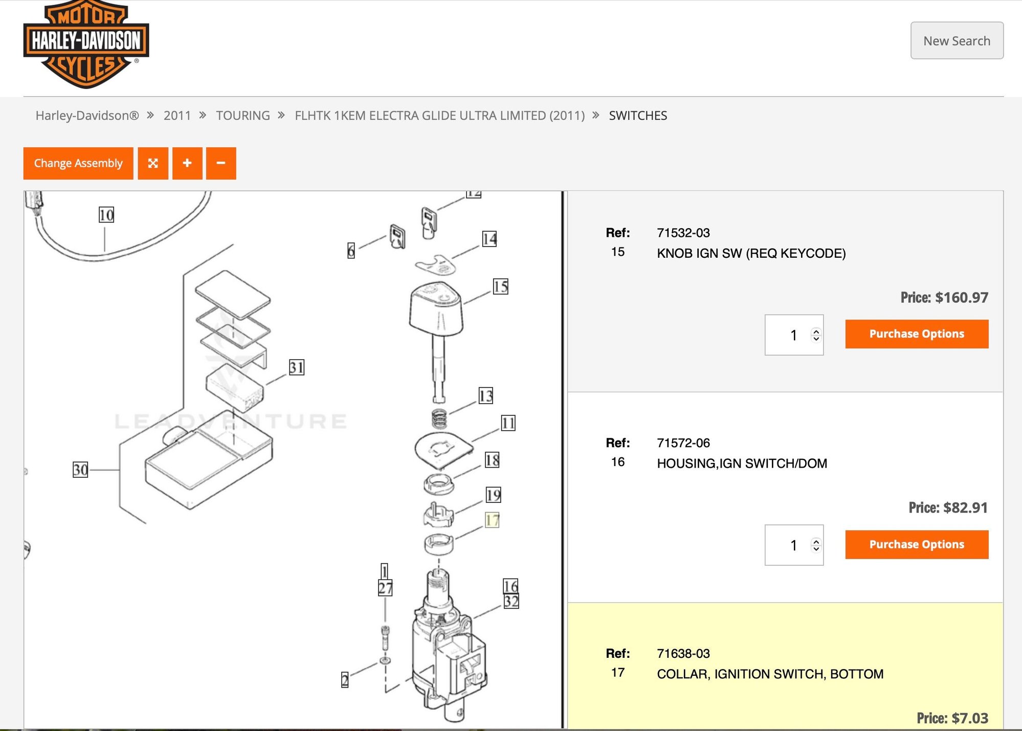

Both of my Harleys have been Road Kings. The ignition switch on those is easy to take apart and clean the contacts, don't know if an Ultra has a similar switch or not.
They are a diffrent switch, but that being said I have seen a video from tube-u that shows how to take mine apart. I am sure I can handle it if it comes to that but I am not sure if I can get just the electrical part of the switch, or if I would need to get the whole thing and end up with a different key ?
FWIW... If it comes to it...
I changed out the ignition switch on my '16 bagger. It uses different parts, but they look a lot like this parts diagram for your 2011 FLHTK. I was able to replace the ignition switch (#16) and keep the old ignition switch **** (#15), which requires the key. So I kept my original key. But if you needed the switch **** too, they can key it to your old key with your current key code.
