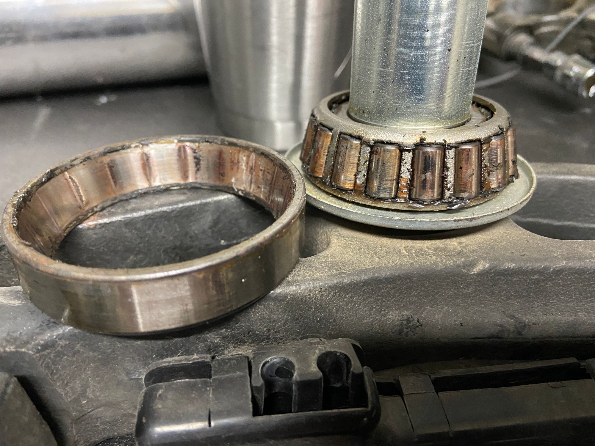

The MoCo decided that grease was too expensive on the ‘14s, so they just barely kissed the bearings with it.
I’ve done 2 of these now and they both looked like this. Mine has never seen a pressure washer but has been ridden in the rain, the other owner claims he never pressure washed his either, and is a fair weather only rider.

Bearings are designed to rotate.
These head bearings at best rotate 45 degrees back and forth absorbing constant up and down hammering. Looking at the above picture you see these abnormal wear marks in the race where the rollers spend most of their day. What are the likely causes of such wear? Vibration and inadequate preload when the bearings have no relative motion?
Lubrication is not as critical in this application as it would be in a wheel bearing for example.
The key is regularly scheduled maintenance to pack the bearing if needed and to make sure the preload is set correct. If I am going into it, I will replace with new bearings while there.
I think we are better off not have the grease fitting on the neck. You can look back 15 years and find threads of what type grease to use and all the examples of too much grease and it was leaking out the bottom of the neck.
Just do the scheduled maintenance and you will be happy.
Swing arm bearing wear and crappy stock air shocks can also contribute to this problem.
Must be why they decided not to use any.
I'm truly hoping you're kidding though. Any bearing that's loose enough to move at all will benefit from a layer of lubrication between the load bearing surfaces. There isn't a rubberized steel seal at the bottom of the neck now like there used to be, just a steel washer, so water can get in / grease get out with zero resistance.
