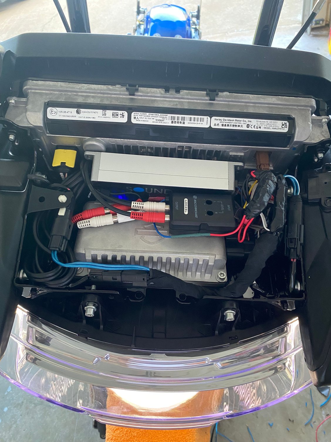

With the two current aftermarket options available for improving the stereo’s sound being extremely expensive, I will installing my own version this weekend. Rockford is super simple and plug/play but not loud enough and the “Modified” Kenwood alternative is too pricey for the amount of wattage they provide and you still have to do several things. The “Modified” part about the Kenwood XM160-2 is that it has a remote turn on wire which most amps already do. They use the factory amps speaker leads to plug into the Kenwood’s hi-input instead of using rca cables. The Kenwood still requires power being routed and the remote turn on connects to a purple/blue remote wire in the Harley stock wire harness inside and under the fairing (this can be done with any amp that has a hi put option and a remote power).
I will be using a stealth 1000w amp that I had in my previous street glide & I will use two sets of 2 pin connectors (currently unavailable from Harley) to tap into the stock amps output and then plug into the speaker leads. I have not decided if I will try to de-pin the harness for the remote power wire or just use a wire tap but I’ll decide this weekend.

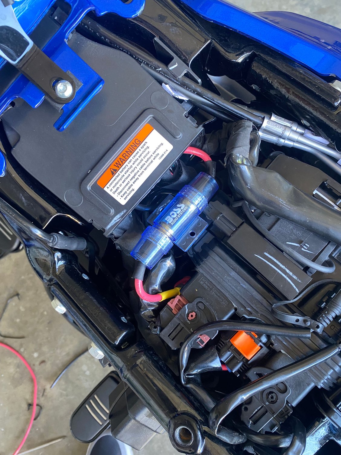

i finally finished it today and it sounds killer. The hardest part was building and crimping the Molex connections. I did not buy a crimping tool that I’ll never use again and couldn’t locate one at work. I did end up installing a line output converter so I could increase the gain some. Tried to wrap everything and did a little cable manage. I also had to relocate the excess cable for the headlight so that the amp would not rest on top of it. So far I’m pretty satisfied with how it turned out.
Ran both 10awg leads through the backbone and up into the fairing. Both are insulted and wrapped. I had a 50amp fuse from a previous project that I used.
Final results. The amp is slim and fit in the same location that the Kenwood alternative would rest.

Awesome! What did you end up doing for the remote?
HD would be proud to see you splice a blue wire to a red one 😆
LOL- the red was another left over from a previous project as well.
Behind the light, the main wiring harness has a purple blue stripped wire that Is only pinned on one side. Harley added this as a 12v remote. I used a wire tap instead of trying to de-pin the factory harness. I found this out on the volunteer audio YouTube video about their Kenwood install.
