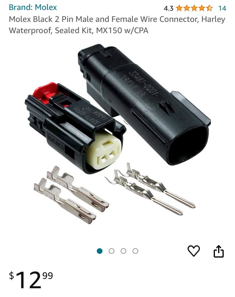

I will be using a stealth 1000w amp that I had in my previous street glide & I will use two sets of 2 pin connectors (currently unavailable from Harley) to tap into the stock amps output and then plug into the speaker leads. I have not decided if I will try to de-pin the harness for the remote power wire or just use a wire tap but I’ll decide this weekend.

Here are the molex 2 pin connectors if anyone else is interested in doing something similar. Part #33481-0201 & #33471-0206
