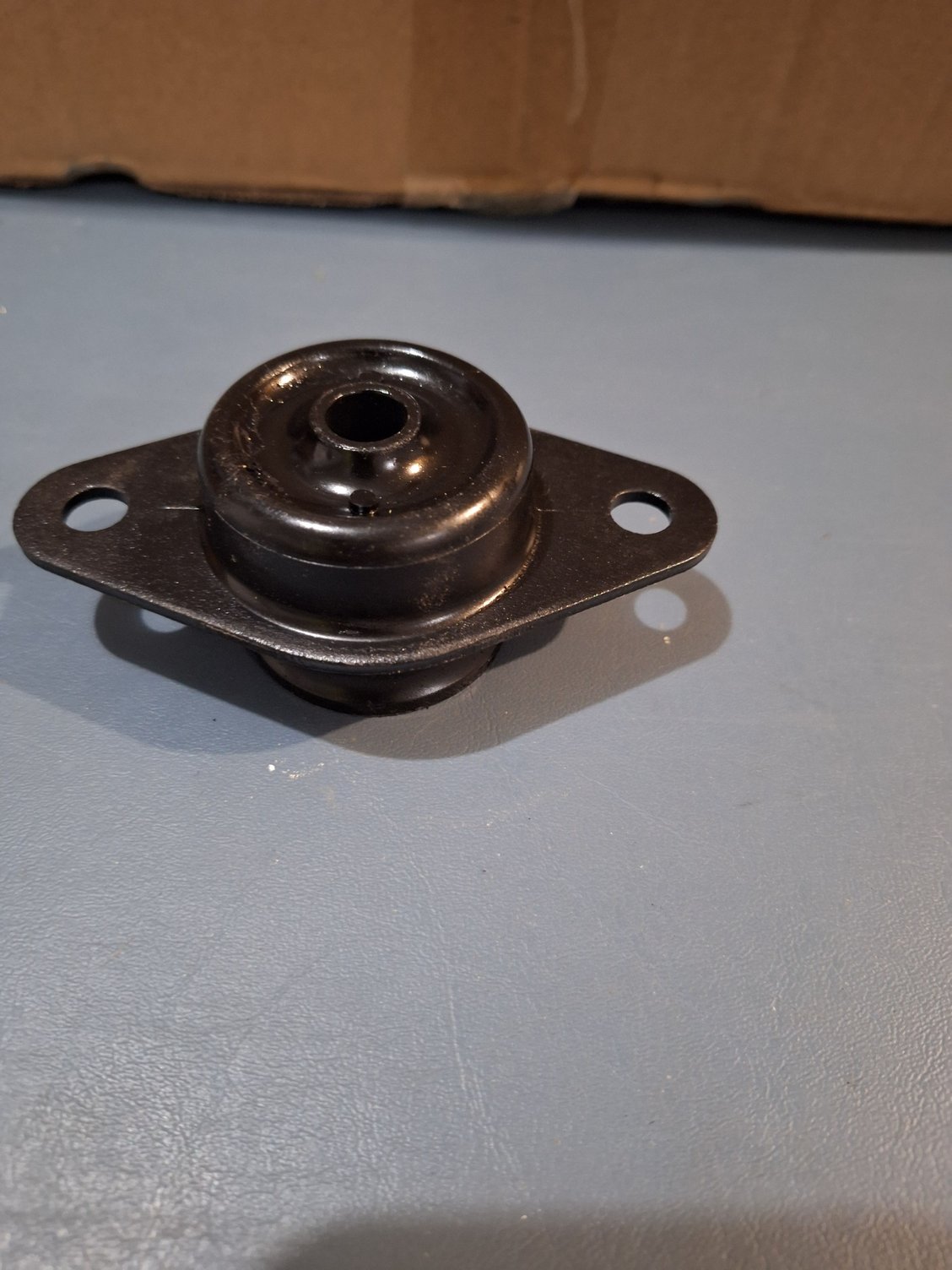

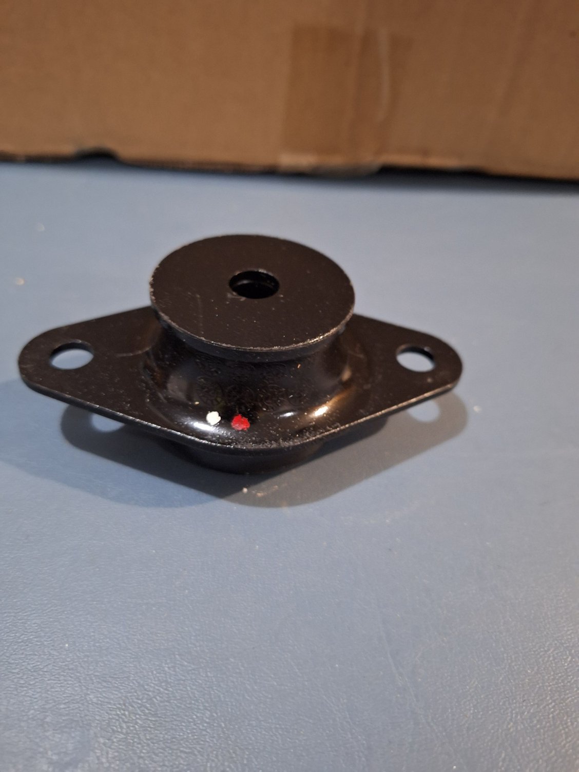

Back at the end of May I had posted a similar question...I don't know how to connect you to those posts but they are listed in my post history...I had tried the Glidepro mount and had terrible results. Someone on this forum pointed me to Barry Controls, they make mounts for different applications, our HD's being one of them! They have multiple mounts with different stiffness ratings. Look into that, I installed one of their mounts on my 2000 flhtpi and couldn't be happier. Great customer service and reasonably priced...highly recommend in checking them out.

Go to novibration.com and get a barry control
507-1ns mount it has the Red&White dots on them.
