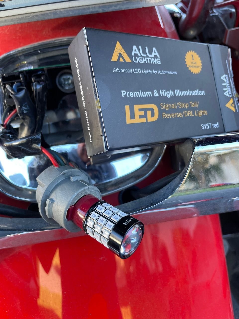

Here’s what I just added: brighter than stock LED and it flashes 3-4 times then stays on solid. Two to a pack.
Unfortunately they're not compatible with a 2010 RK.
Too bad........I would like to have tried them.

Then find the ones that do! Amazon baby!
What bulb does ur 2010 RK have?
These 3157 fit my 2010 FLHTK….
According to Ronnies, an FLHTK is an Electra Glide Ultra Limited. Oko seems to have no direct knowledge of Road Kings and assumes all Harleys are equipped the same way.If his rear turn signals have not been modified by him or a previous owner, it then seems not all Harleys have the same rear turn signal wiring. Having had 2 Road Kings, I can vouch that the rear turn signals are set up for 1156 Single Contact legacy bulbs, not the wedge base bulbs, and not for two filament bulbs regardless of base type. To get 2 filament bulbs to work as run, turn signal and brake lights would require extensive rewiring. The only EASY way to convert Road King turn signals is with a Harley or after market converter that makes a single filement bulb work at two brightness levels at the appropriate times.
