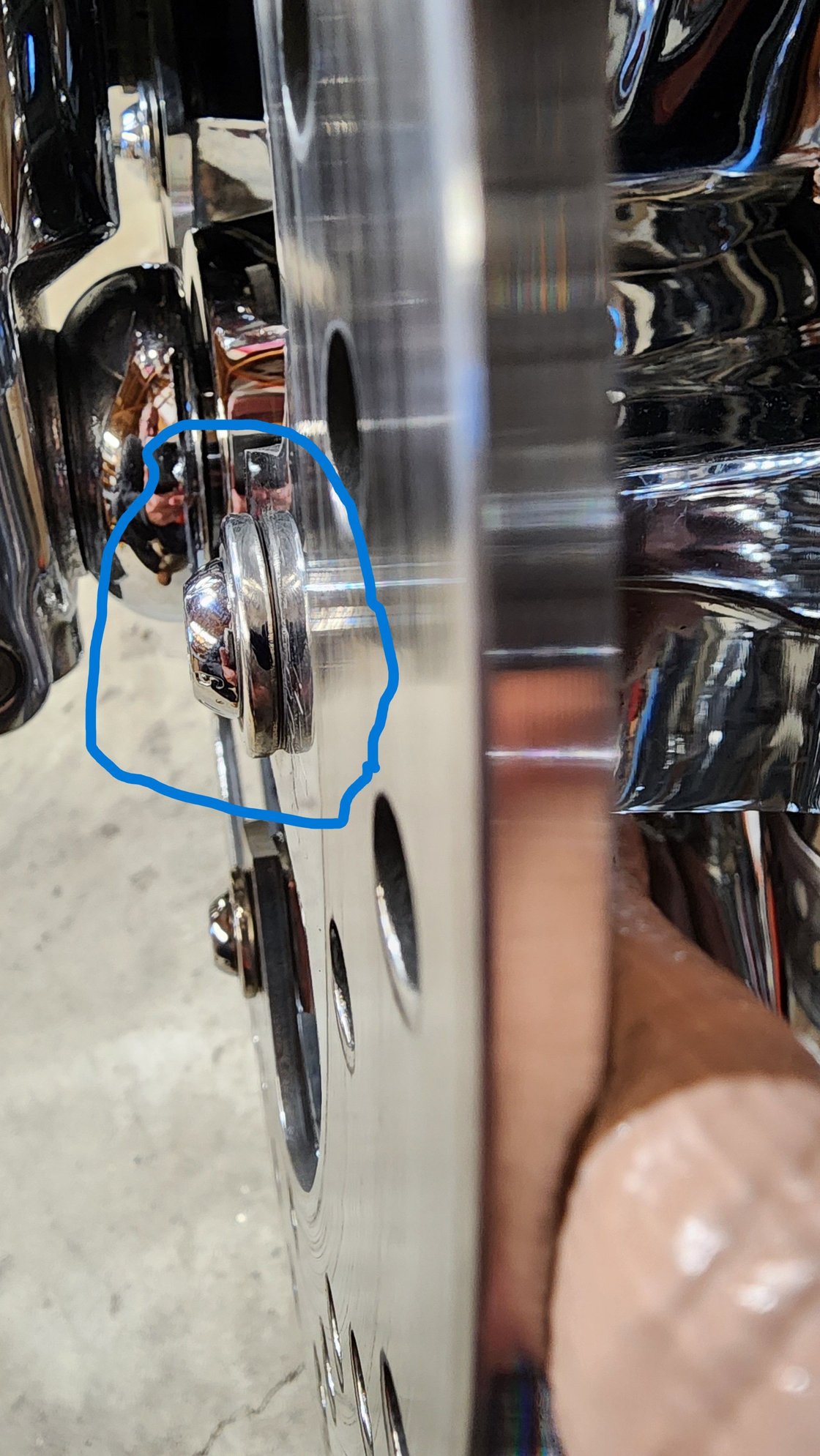

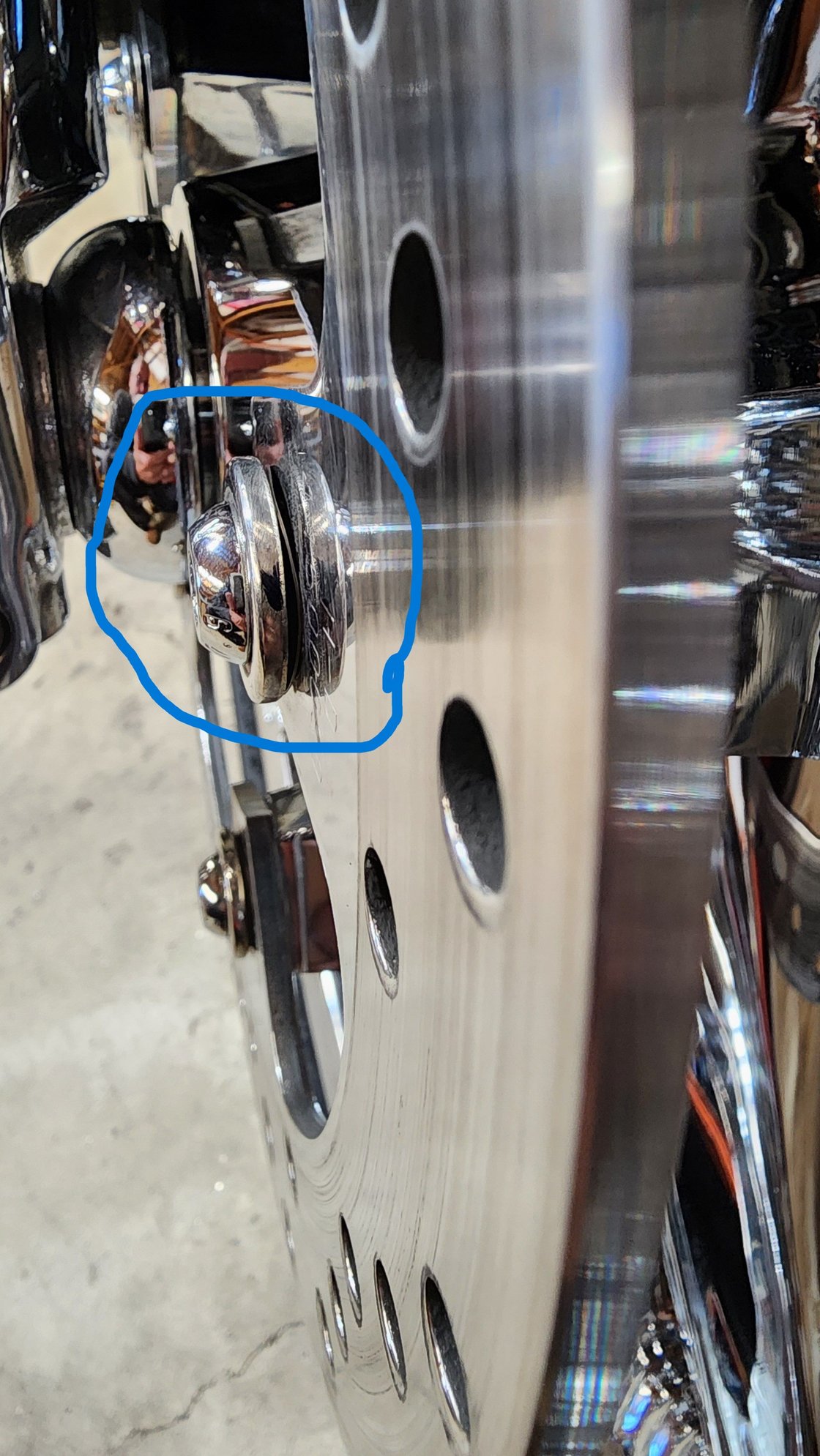

As a quick/easy/free check, you may want to make sure that you didn't get a tiny piece of sand or something back in-between the inboard surface of the rotor and the wheel boss where the rotor bolt attaches the rotor to the wheel. I found that recently on my 14 SGS just before a long road trip and thought I was going to have to replace my rotors. It caused one of the rotors to show about 0.020" warpage until I removed the sand or dirt. It want back to normal after that.
But I would think that if your calpers aren't retracting properly, that if one of the brake pads may have rubbed on the rotor hard enough and long enough, it could cause excess heat on the rotor, but not sure if it would get hot enough to warp it. MAYBE if it was pre-heated like that then followed by a long session of downhill twisties with heavy braking?
The pics below show how much space can open up to allow junk between the rotor and the wheel..........
