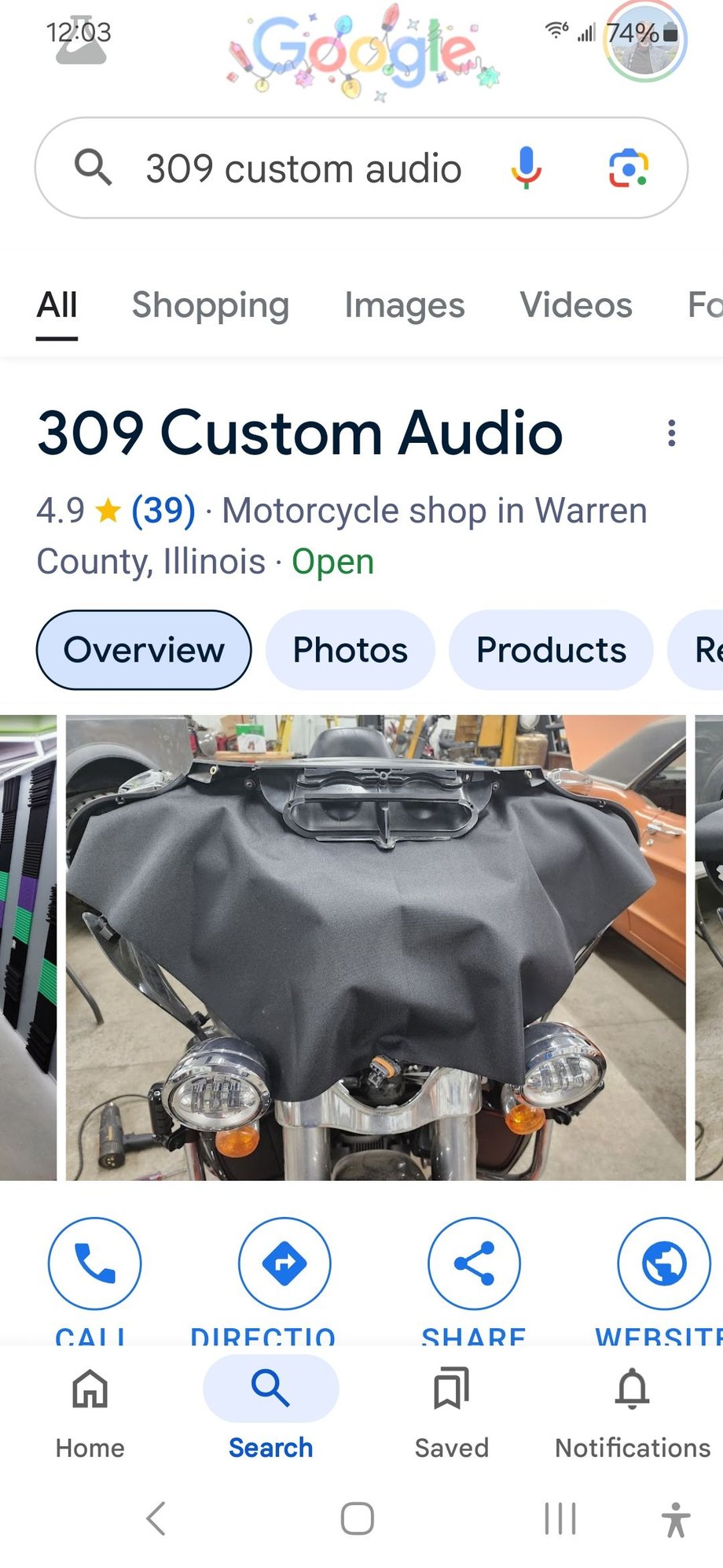

I had a Rockford Fosgate system in my Tri-Glide that the wife got me as gift. After about a year, the amplifier had been getting wet and failed.
I was looking for a solution and found a company named '309 custom audio' that makes a waterproof breathable cover for our bikes. It's die cut and hole punched to fit inside the ffairing. I got one, replaced the amplifier and no more water issues. I think I had to email them and they got back pretty quickly with what I was looking for. Worth checking out if your amplifier is working, you like what you got, and don't want to spend a bunch. I think it was around $40.00.
