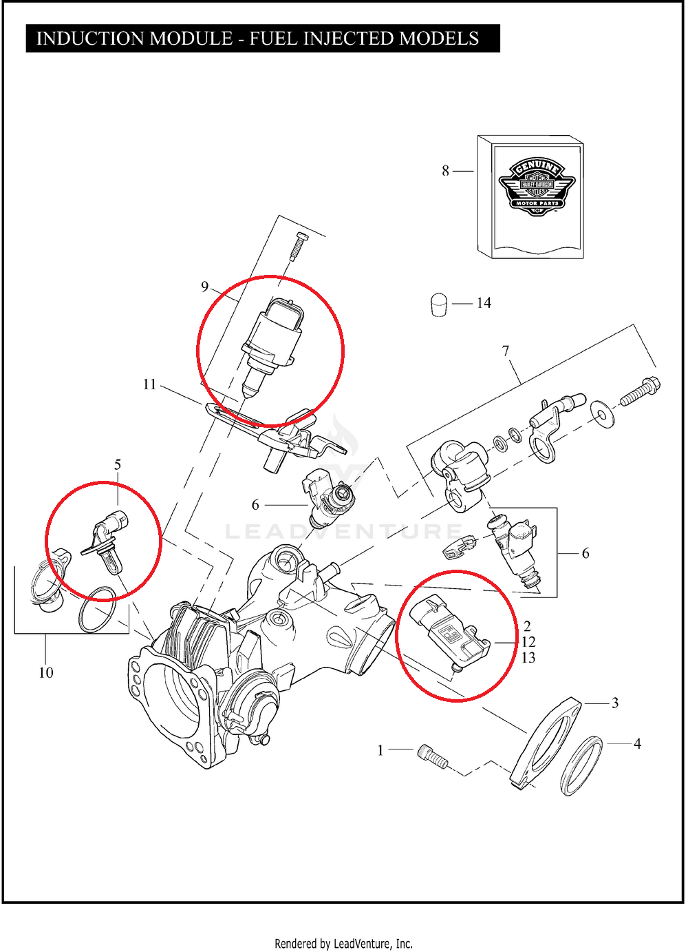

6. May want to clean/check your Manifold Air Sensor, your Air Idle Control and your Air Intake Temp Sensor.

........i'd clean the air idle control as a starter.

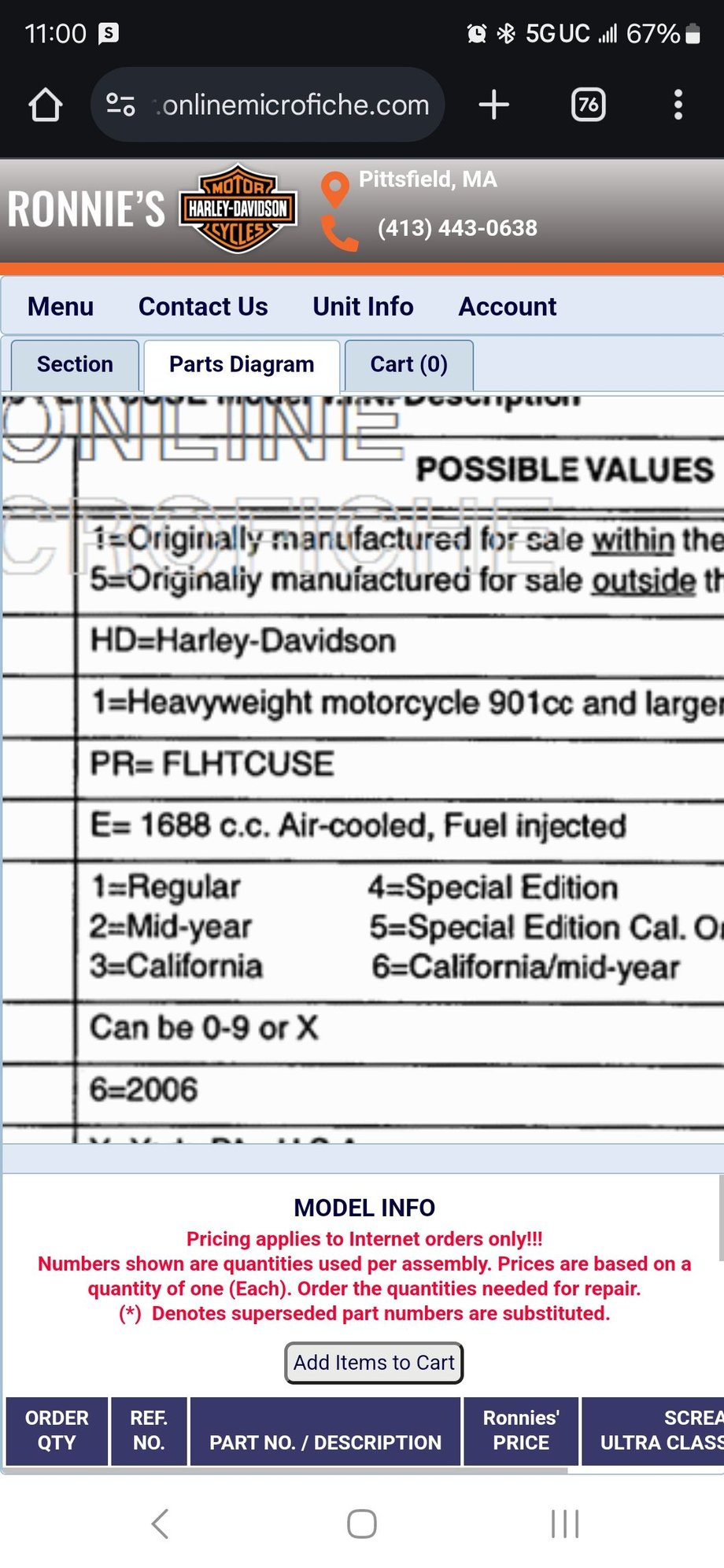

@svarnster ( svarnster.. Go figure? I assume Mr Whisper is correct. Maybe engine has been changed. They look basically the same since only stroke changes. And it would be a 6 speed if built originally as a 96 like in 2007.

Ronnies fish says the 2006 SE Ultra was 96 but with a 5 speed.
I suspect it's wrong.. The CVO SE Ultra is a 103.. with a 5 speed..
And right you are. I glanced at the engine listed in CC and did a calculation in my head...
