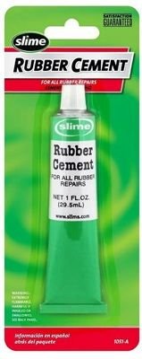

Hopefully you lubed the hole with some rubber cement glue. What tire plug where you using, one of the gummy rope styles? If you do not lube them with rubber cement they can be difficult to insert.

Ream the hole very liberally. It seems counterintuitive but the hole needs to be big enough for the plug. Some swear by rubber cement as lube, I apply a generous amount of spit. A buddy of mine carries a tube of beeswax lip balm in his tire kit - not sure how well that'll work out but he swears by it.
This is a necessity for plugging a puncture.
