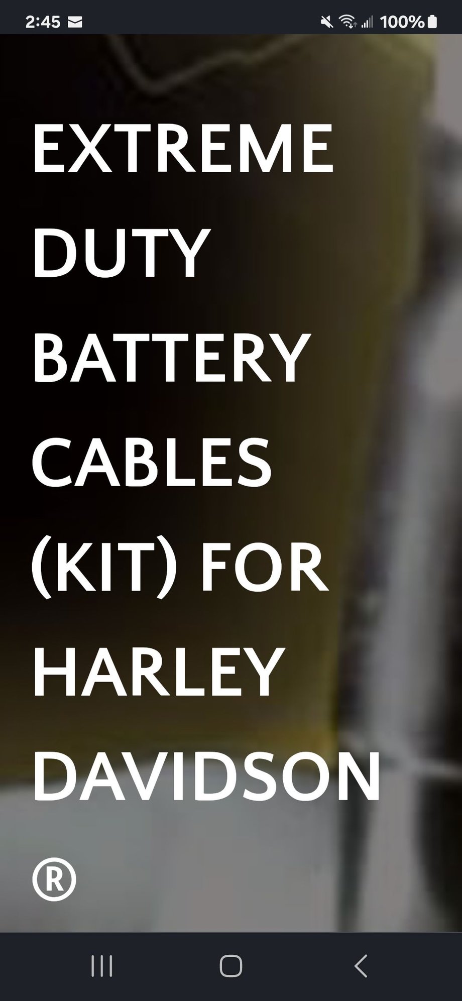

Sumax offers heavy duty battery cables.
or you can make your own. They do help.
Never been convinced that you need bigger battery cables on such a short run. I don't it will do much for you.
What ever you say.
You don't no much about resistance and current do you.
