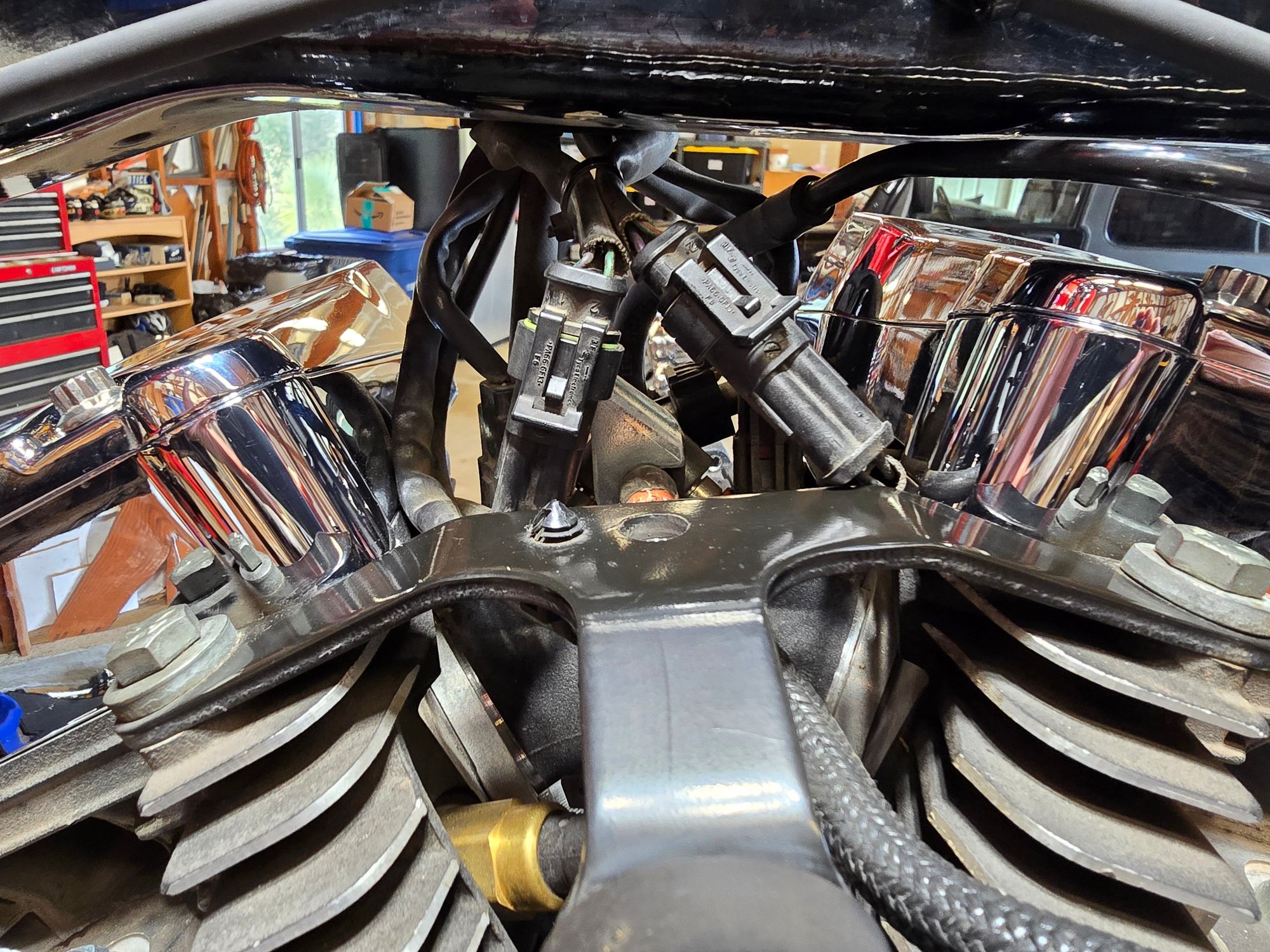

Glad you successfully completed the test. Were you able to access the ACRs by just removing the tank and nothing else?

I have the tank off anyhow for a seeping rocker cover gasket, so it DEFINITELY made it super easy to get to them. Never looked to see how accessible they are with the tank still in place. I knew the tank was coming off this month, so I just waited. You can see how available they are with it off though.....
