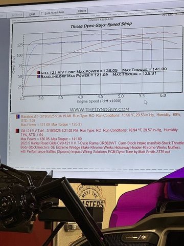

Default 2023.5 CVO RG 121 VVT cammed and tuned

Great questions: I think the reliability factor increased as we upgraded the lifters, bearings and added billet lifter cuffs and got rid of the plastic ones that come in it from the factory.....plastic parts in a motor from the factory....yikes. There was no need to delete the VVT and all it its virtues now that Cycle Rama has a cam out for these bikes, And as the dyno sheet shows the power is instant, everywhere and very linear. I'm very happy with the end results as they we exactly what I was looking for to align with my riding style.

I spec'd my build my way. With input from my tuner. No one sold me on anything I didn't ask for in fact I was talked out of a bigger intake and bigger throttle body since I don't ride where the impact would hit on the top end.
***I'm happy with my package and the end results and that's all that matters right?***
I posted my results for others considering going down the same or a similar path as I couldn't find a lot of data out there at this point.
The CR562 VVT cam was recently introduced in the last week or so so folks can now see how it turned out via my application as they weigh their options.
