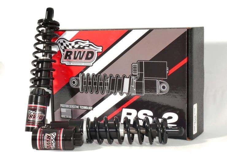

From: Lost
Originally Posted by Dano523
No need to send out the rear shocks, just pull and drain them with vac pump, and then refill each with 10.5oz of fluid.
You can refill 2016 shocks? How? They don't look like the ones you show above.
Thanks!
I’ve RWD shocks in the rear. Not factory. I don’t have the tools, space or skillet to do all these repairs. So I’ll have to send it RWD for rebuild.
I may even consider getting top of the line Ohlins, and keep rotating when others are out for rebuild. Not sure if that’s a good idea.
