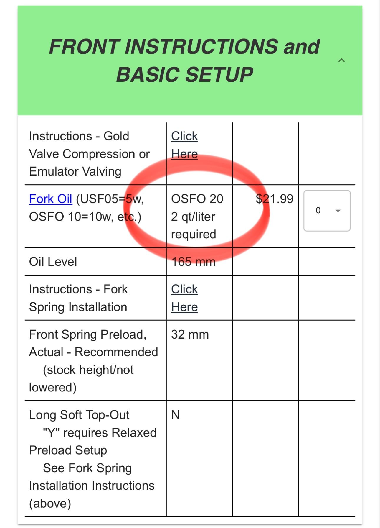

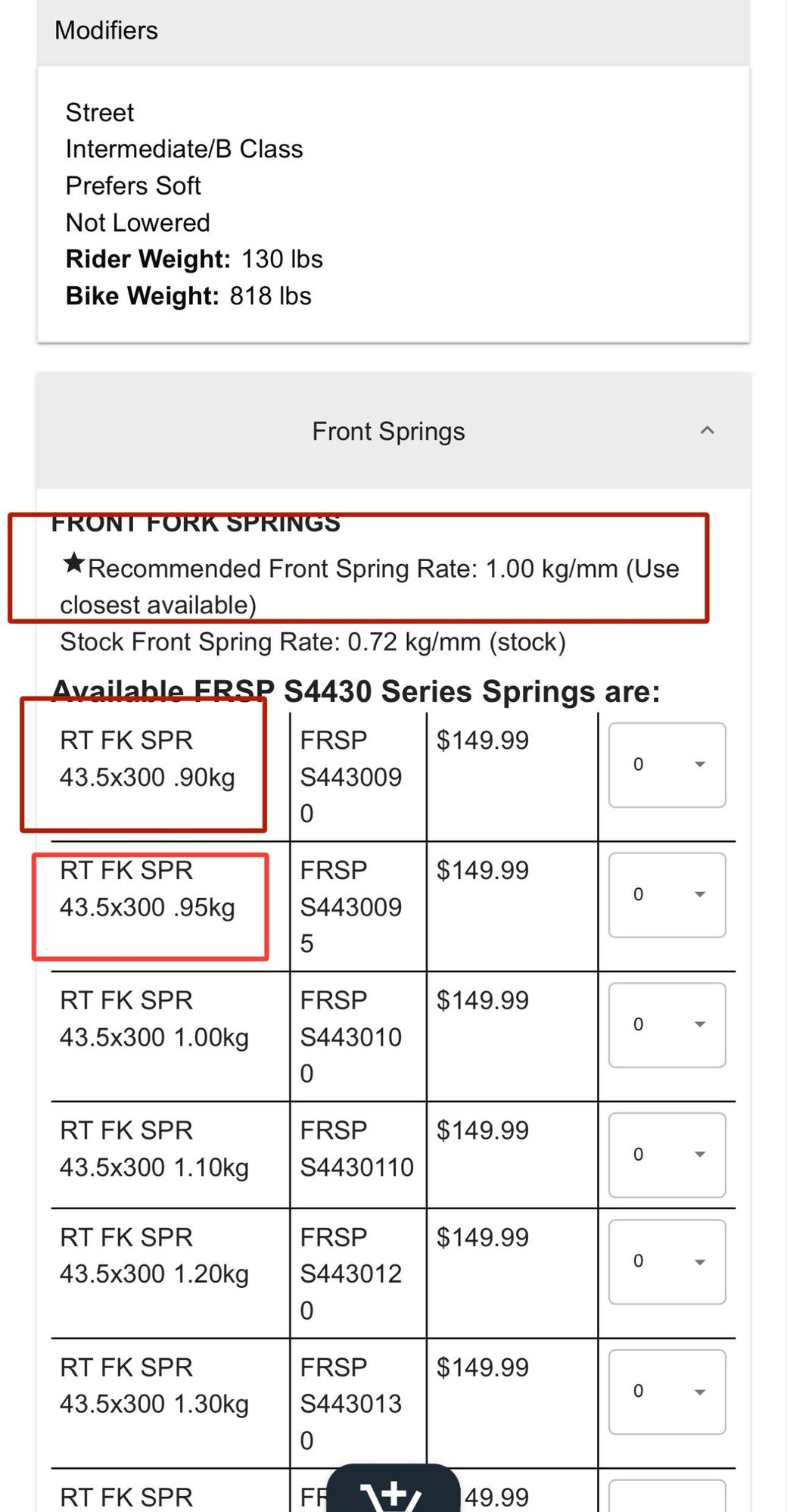

I’m thinking of upgrading my front suspension. After looking at bunch of options, I believe Race tech suspension with their spring selection will work for my situation as I’m on lighter side (130 lbs).
I’m looking for soft ride with no brake dive. When I put my info in their calculator it recommends spring rate starting at 0.90 kg/mm 0.95 kg/mm and 1 kg/mm.
Their website says use 1 kg/mm spring with 20 WT oil.
I’ve read several posts here that said 10wt oil worked for them to have a softer ride.
I’m thinking of 0.95 kg spring (stay middle of the road) because of 20 wt oil. Is my thinking wrong?
For reference it says stock spring rate is 0.72 kg/mm

You are in the weight range for the stock springs to work well. I'd recommend the DK Custom Intiminators and the oil recommended by RaceTec.

When Racetech recommends 20 wt you need to use their oil otherwise use 10wt for most oils like Bel-Ray or Spectro.
The cSt measurement is the relative measurement of viscosity @ 40C
https://www.teknikmotorsport.com/tec...weight-table/?
