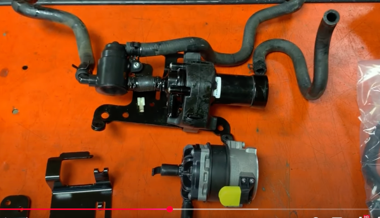

Originally Posted by Oko
First thing I would do is verify you have the upgraded pump. The new one has no thermostat and runs all the time.
(someone correct me if I'm wrong)
Just pull the black cover off. You can tell because it won't have the "blob" that was the thermostat.
The cover then snaps back on to two grommets at the bottom.
In this photo, the newer one is at the bottom. And it's shiny too.
I thought I saw where the new one has an internal thermostat built into it.
at the 1:25 mark

[QUOTE=elPrez;21982009]I thought I had seen where the new one has an internal thermostat built into it.
at the 1:25 mark[/QUOTE
It is the OEM black long one, original to the bike. I' just finished removing it and am going to bench test it with 12v to see if it operates.
