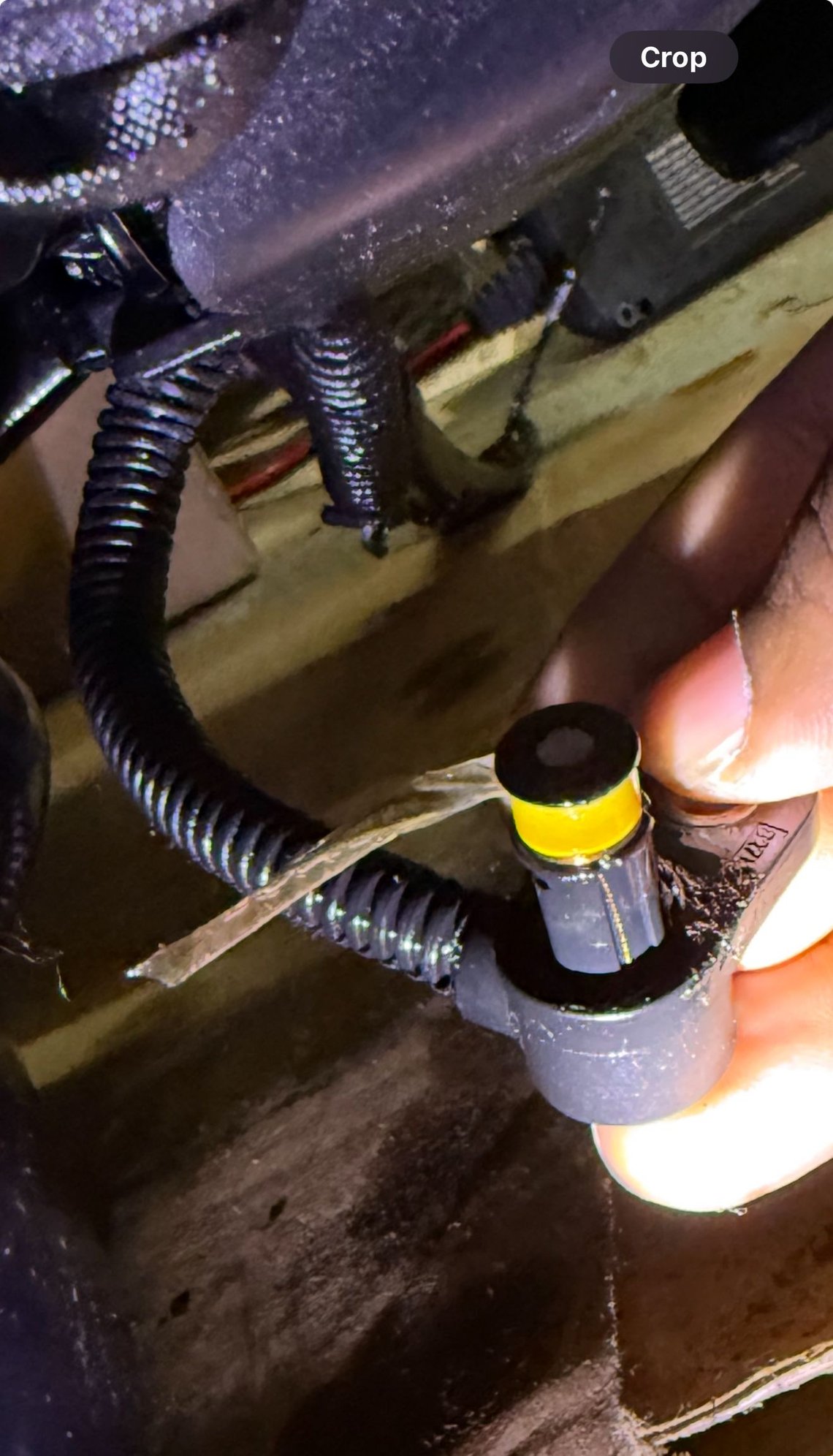

Heat has killed 3 crank sensors within 400 miles (last one melted). After the 3rd the motor was torn down all the way to the crank. Oil pump seal was blown, no other visual problems. Tune has now been modified, and adding Ultra Cool parts as we speak (oil cooler, filter, and HD oil cooler fan). Fingers crossed for the best. 129" 11.25 motor.
