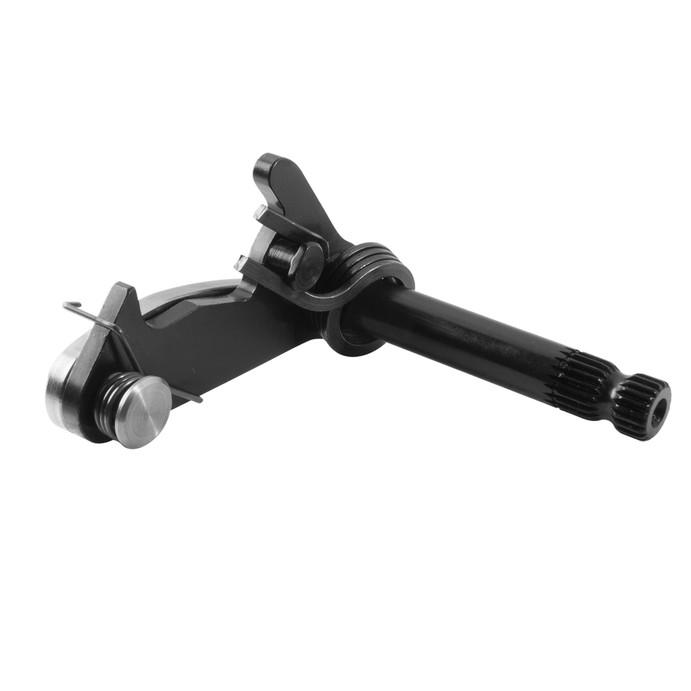

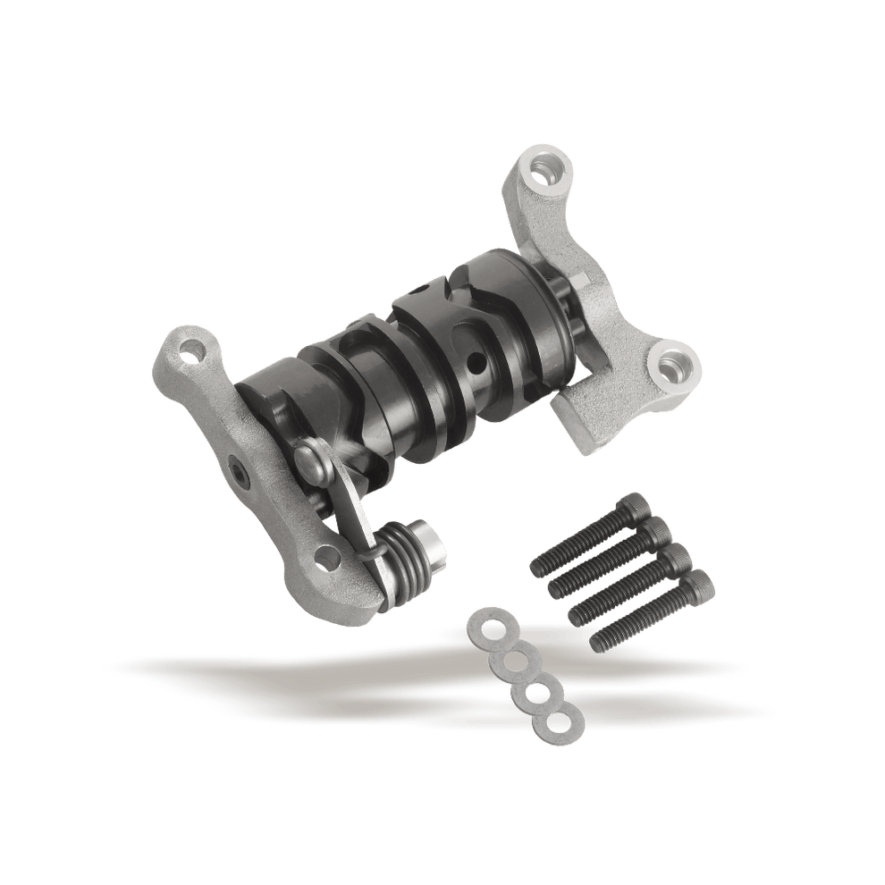

Problem is easy to see, since your using the baker smooth shift kit (drum),
and need to use the Baker anti over shift ratchet pawl assembly with it,

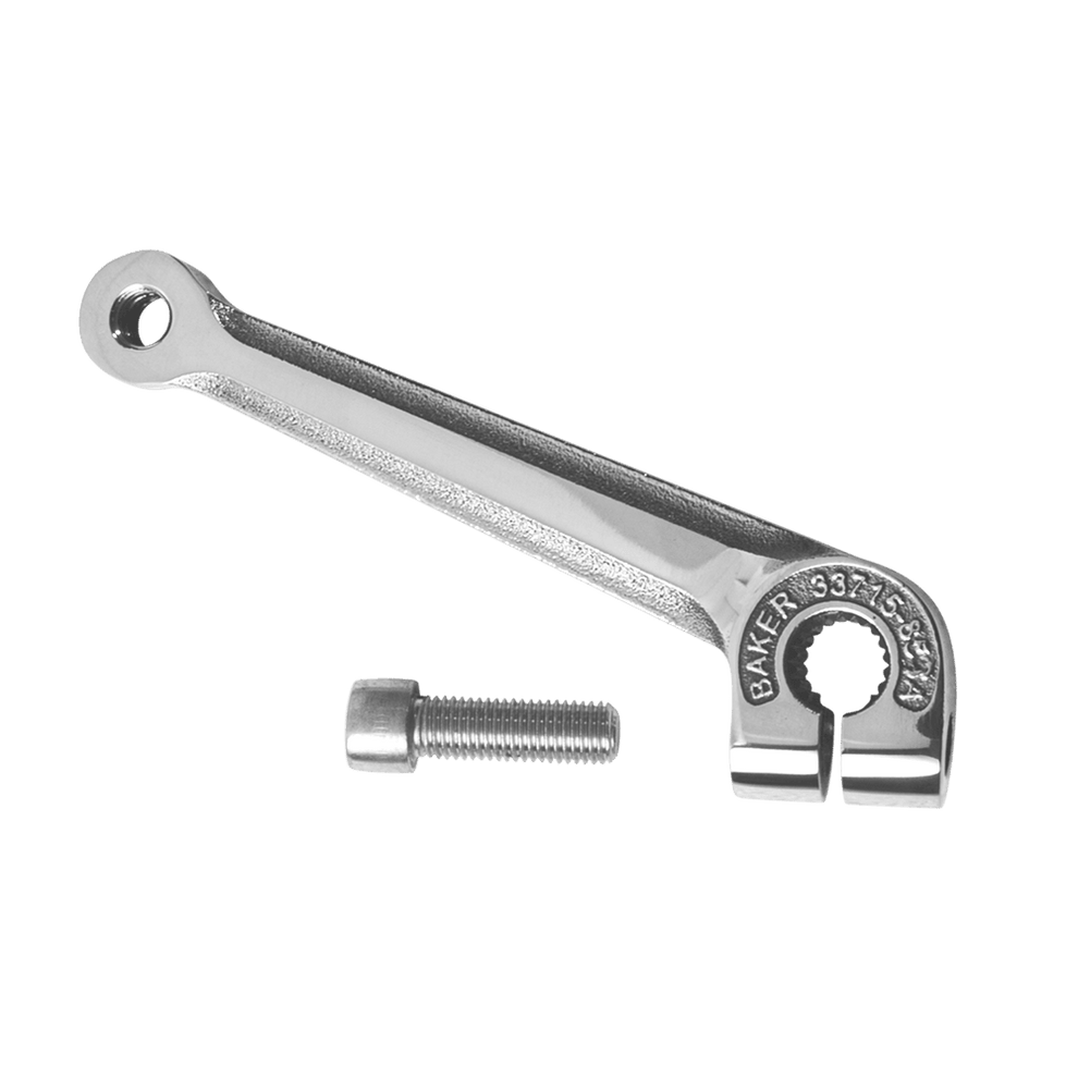

While your in there, May as well ditch the pot metal shift lever to Baker truss style shifter levers, since even with the bolt tight, just a matter of time until the lever gets loose to the shaft again.
And with the amount of slop of pawl shifter shaft to trans housing sleeve now, even with new pawl assembly in place for that shift drum kit, replace it with new housing sleeve of going to have the same sloppy mess during shifts.
So to recap, trans lever is loose to pawl shaft now, may have to pull the lever to increase the slot to be able to tighten the bolt up to get it tight to the shaft,
pawl shaft to trans case sleeve/busing is a joke with sleeve way worn out/sleeve for the pawl shaft need to be replace in trans case, and need the pawl assembly that goes with that shift assembly as well.
Hence the factory pawl with the sold bolt non adjustee, can not drop front pawl down in front of pin at the same time back pawl drops down behind the pin Also, Notice when you pull the trans shift lever back forward to try to get front pawl hook to drop down in front of lever, rear pawl hook is just pulling back on the drum to move the drum as well
If you want to play the tweak game to try to get what you have to work (pawl hook distances and the Baker drum), without having to get new parts (after you replace the pawl shaft sleeve in the trans case), then get Baker on the phone to see what they have in ideas.

As stated, the pawl asssembly in play now, does not have enough room between its hooks in what is going to center as, to allow it to drop both sides down on the drum pegs.
Maybe you can tweak the none adjustable bolt (36 below) end to solve the problem so both pawl hooks can index to drop down both side when it centers, or may have to tweak the pawl hooks to make slight more room between them, so both hooks can drop down in place. Right now, even when you forward blip the trans lever to let the front hook drop in place behind the drum pin, the other pawl hook is slightly too tight to it pin on its side.
2005 5 speed trans, and notice the differences in the pawl assemblies between the older trans, and the newer trans, and may be the problem is only older style pawl assembly is being used for newer drum style drum now (read need to use a HD34972-02 pawl assembly for newer drum style)..
