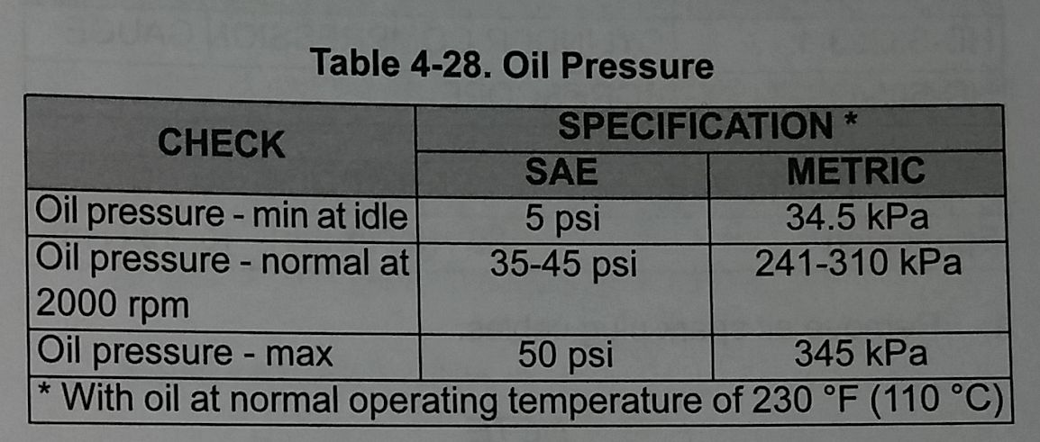

Old Jul 12, 2025 | 03:42 PM
KMRolling's Avatar
KMRolling
Joined: Jun 2025
Posts: 45
Likes: 84
From: Northwest MS
Photo from Twin Cam Manual-
Kevin
Old Jul 12, 2025 | 04:04 PM
Pats06Glide's Avatar
Pats06Glide
Stage III
Joined: Jun 2024
Posts: 3
thanks you
