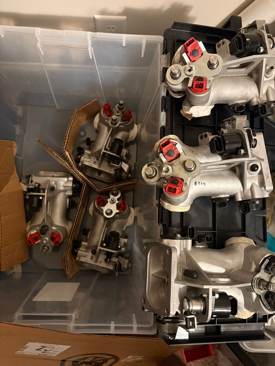

Originally Posted by xcbullet
Correct it will not be right and would need a new tune. Check the one thats on it if its not consistent you need to find a oem one. Maybe Ed on her has one.
I happened across this by accident and saw you referenced me. This is all I have left in the world plus two NOS Screamin' Eagle Throttle Bodies for MM which a lot of people have never seen. The one marked ORIG is from my personal bike when I did the Delphi conversion.
As mentioned in the thread, the aftermarket sensors may bolt on but are not the same internally with the values at different positions.
Thanks. I’m going to return what I bought as I now know that the factory TPS was not bad.
