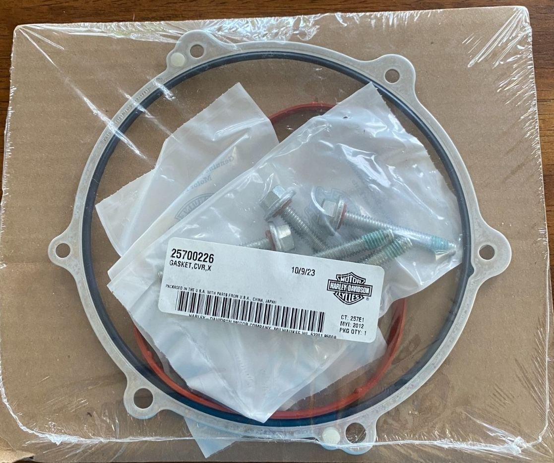

OP, get the #25700226 Inner Primary Gasket Set...
It will have most of the wear parts to the inner primary you would need, in order to remove & replace the Inner & outer primary.
I believe it comes with the starter o-ring. It also has the five inner primary case bolts with the sealing bolt heads, which normally cost $5 each. Unless your dealer does parts mark-up over HD MSRP, it should cost $68.58. That is cheaper than buying all those parts separately.
The gasket set doesn't include the outer primary cover gasket, but that can often be reused if not damaged when removed. It does include a new derby cover gasket.
If you want/need to replace the shifter shaft seal, that will need to be purchased extra.
You can get that gasket set in black so you don't have a silver line between the primary and engine.
@cncmike
What's interesting is that the gasket "kits" seem to be almost the same price
HD #25700226 (grey primary housing gasket), US$69.58
HD #25700337 (black primary housing gasket), US$68.95
But the individual primary housing gaskets differ in price
HD #34934-06 (grey primary housing gasket), US$29.26
HD #34948-08 (black primary housing gasket), US$48.13
It's strange that the gasket kit in black is cheaper than the kit with the grey gasket, but the individual black gasket has a US$18 up charge!
