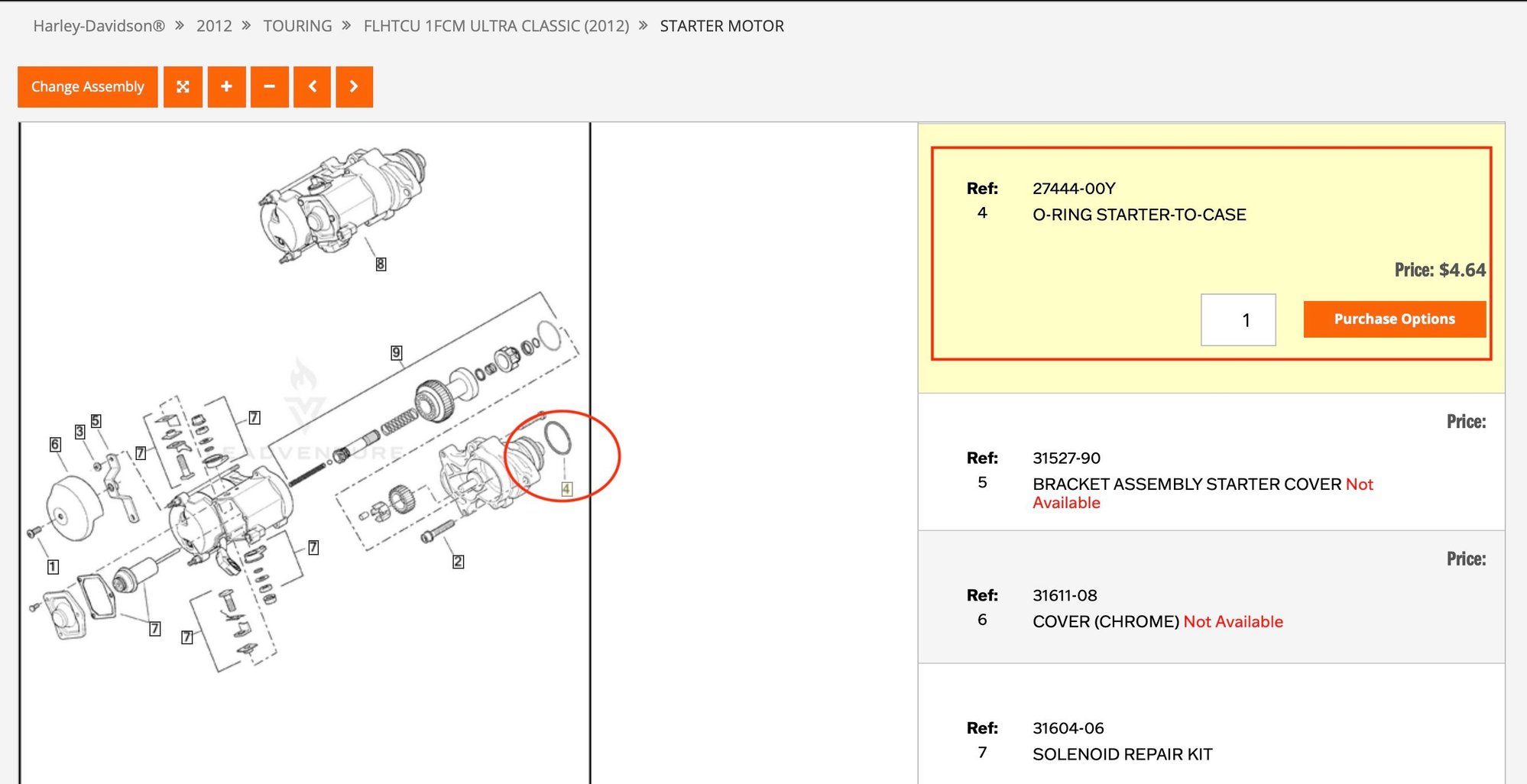

Originally Posted by LQQK_OUT
I didn't think the 2012 Twin Cams had a starter jack shaft seal.
They don't.... They use an o-ring seal between the starter and inner primary case.

OP, get the #25700226 Inner Primary Gasket Set...
It will have most of the wear parts to the inner primary you would need, in order to remove & replace the Inner & outer primary.
I believe it comes with the starter o-ring. It also has the five inner primary case bolts with the sealing bolt heads, which normally cost $5 each. Unless your dealer does parts mark-up over HD MSRP, it should cost $68.58. That is cheaper than buying all those parts separately.
The gasket set doesn't include the outer primary cover gasket, but that can often be reused if not damaged when removed. It does include a new derby cover gasket.
If you want/need to replace the shifter shaft seal, that will need to be purchased extra.
