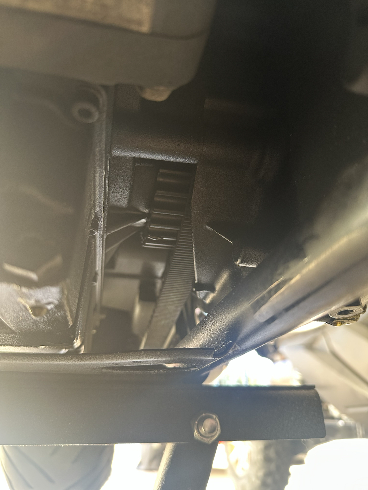

Bad news all... I need advice.
I completed all the repairs with the primary. New seals throughout, new main shaft race, shifter bushings, gaskets, Barnett clutch kit, etc. Everything seemed right as rain, until today... noticed a leak again. See pics. Seems to be coming from the same location as original. All that work is out the window. I'm disappointed and disgusted. I did the absolute best work I could do because that bike is the one I'm married to. (My other one I'm just dating.) I didn't cut corners and was very methodical with each thing.
If all that stuff is new, and let's just assume for the sake of argument that I didn't mess something up, what else could be leaking?
I really don't want to pull the whole thing back apart again. I mean, I enjoy it but now I'm frustrated and just want it fixed... I need to simmer a bit and decide if I want to pull it all apart or take it to the dealer - which I haven't done with this bike in years. I try to take care of things myself and up until now, I've done a damn good job of it.
What would you guys do? It's not a money thing. I can afford it. It's more a point of pride, I guess. I'm just really bummed.
