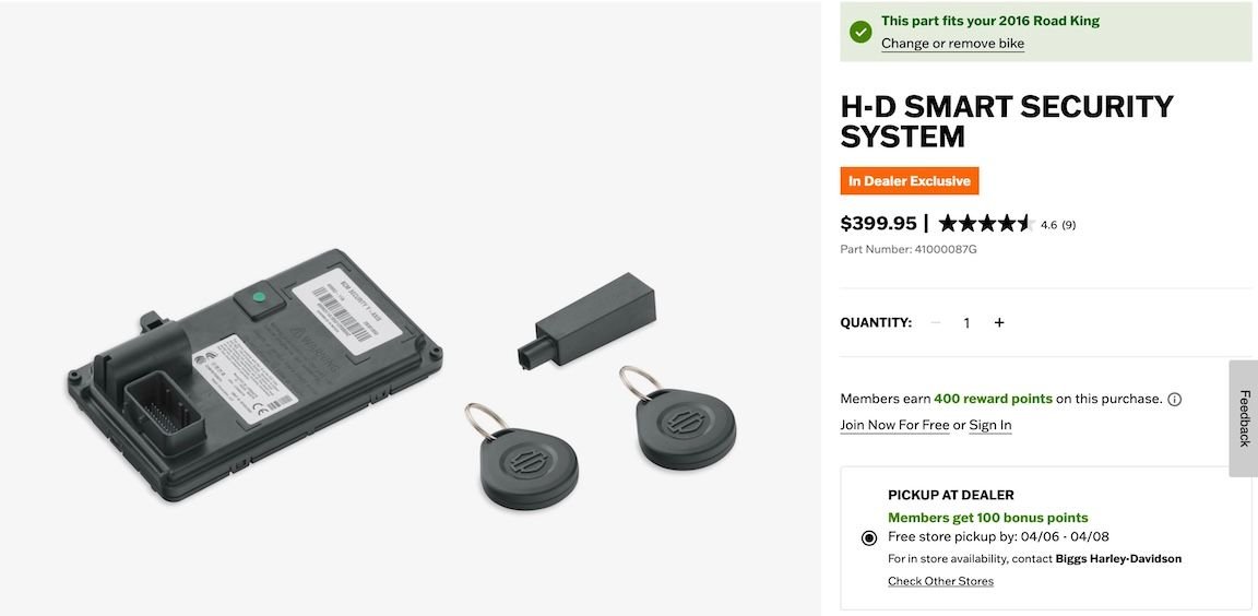

My 16 RK does not have the factory security system and key FOBs. I think the factory plug in system is 399. Are there any other aftermarket systems out there that anyone is using?

The factory system for $399, is actually quite a deal......
It gives you the security BCM which usually lists for $429.65, two Security FOBs which usually list for $94.95 each, and the security antenna which lists for $21.10.
Of course, you will need to have the dealer flash the new BCM to the ECM, unless you have a friend (or know an independent shop) that has one of the aftermarket tools like the Techno Research Centurion Pro to flash the new BCM...
All the components will plug, play, and work together within the bike's CanBuss & wiring system, after the BCM flash...
I've no experience or knowledge about any aftermarket security systems for Harley bikes. I have 5 HD bikes, all but one has the HD security systems, ranging from 2001 to 2020. They all work well.
