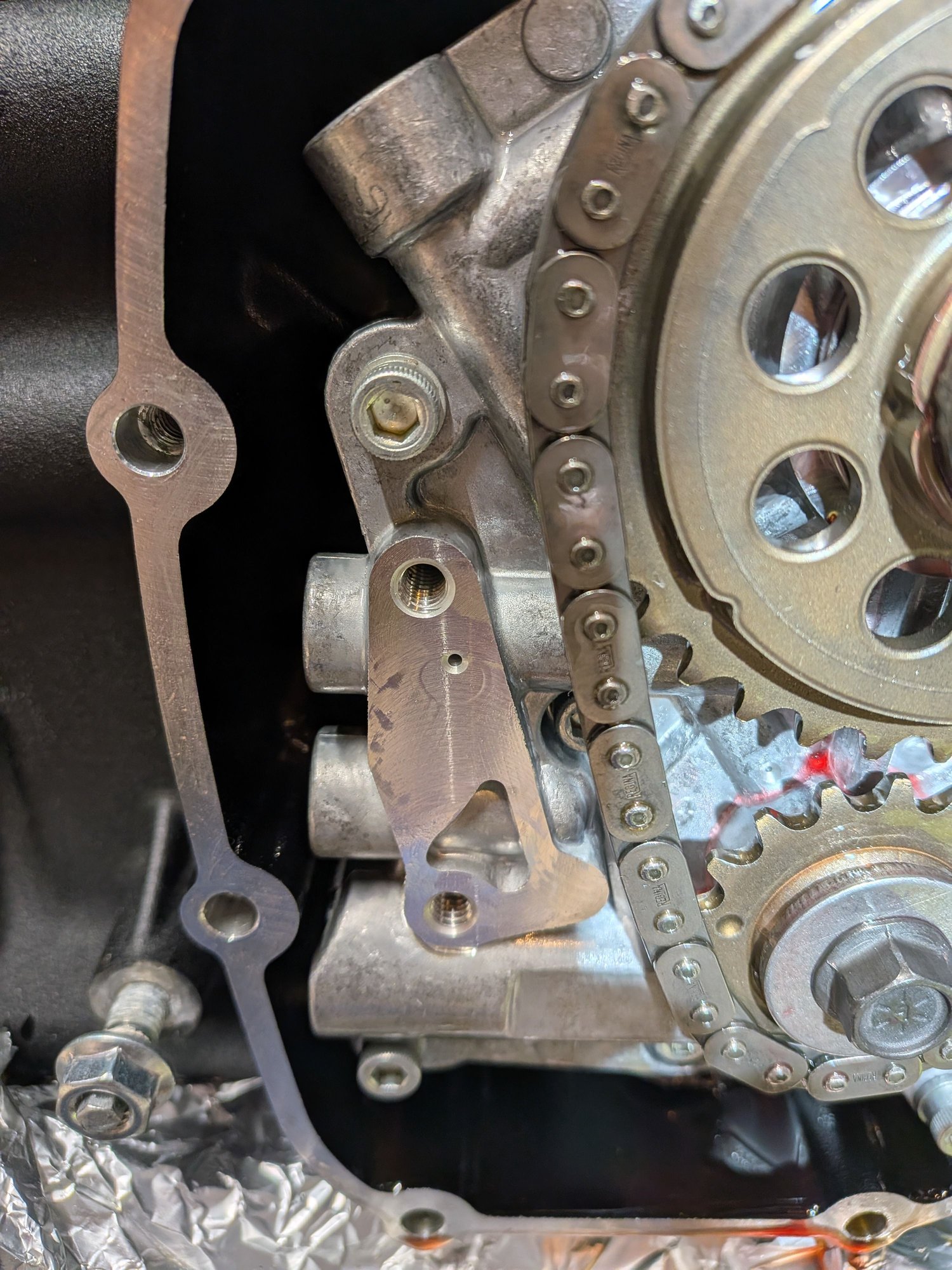

Working on my stage 2 in my 2023 ultra limited. Shouldn't I see oil flow out the feed port to the chain tensioner when rotating the rear wheel? I've rotated the wheel several times maybe 40 or 50 times and see nothing coming out. The cam plate and oil pump are new.

So since the plugs was out. I disconnected the fuel pump and turn over the engine with the starter. I didn't want to stress the starter so I hit with 5 second bust waiting a few minutes between so the starter wouldn't get hot. It took about 5 times and yeah I got oil pressure. It squirted for 3 feet. LOL

Right on, I was going to say, you may be turning that wheel all month to get it to move oil at that port
What cam you puttin' in?

Feuling Reaper 465.

There is a new cam drive retention kit available.
PN 91800088.

Done put it together with the old one part number 25566-06
