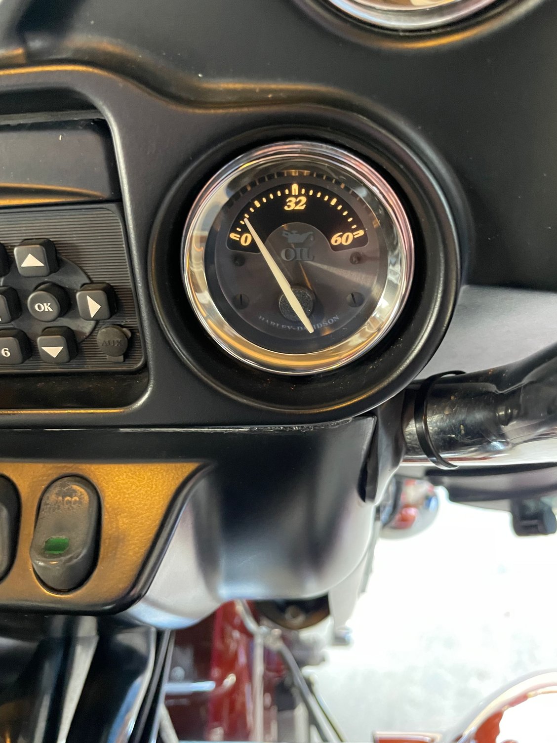

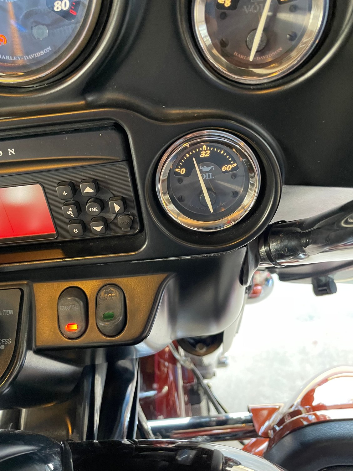

Hi Guys,
I just changed my oil in my 2011 FLHTK 103 with 68K miles. I used Mobil HD 15w-40 Synthetic Blend this time as some say they have been using regular desiel oil for years without issue. I also put in a new HI-FLOW filter because it has the nut on the oil filter.
After the the change I am getting about 3 lines on the gage when warm and idling at 1k rpms, I do get a higher reading when I open the throttle to 2K rpm, attached is some pictures of my Gage, there is no new noises of drivability issues.
Your thoughts...
Is this 5 # of oil pressure ?
Is this 17# of oil pressure ?

Ride it. What were the pressures before you changed the oil & filter? Harley oil systems are more about flow than pressure.

The spec is something like 30 psi at 3K.

NOTORIOUSLY inaccurate gauges.
BUT, what was the pressure before you changed it? Did it change?
If your OIL LIGHT doesn't come on you're fine!

15-40? Try Mobil 1 20-50W, might bring your pressure up a little. And what's with the diesel oil? Sounds very caveman to me!

I run 20-50 Mobil v-twin oil in both of my Roadglides and never had an issue with oil pressure. If you had more pressure reading on gauge before, most likely viscosity is too thin.

OP: as long as you don't hear your lifters clattering you prob have enough oil pressure... As said, these gauges are notoriously incorrect - and at idle, these engines don't need a ton of pressure.
