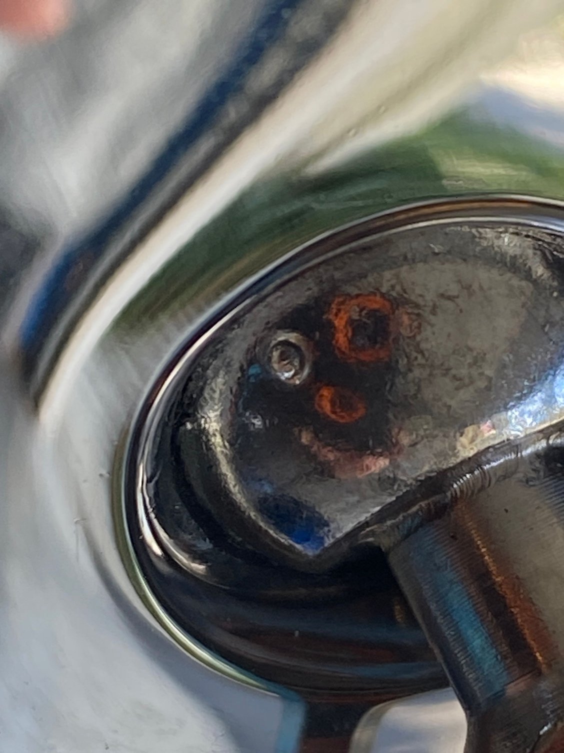

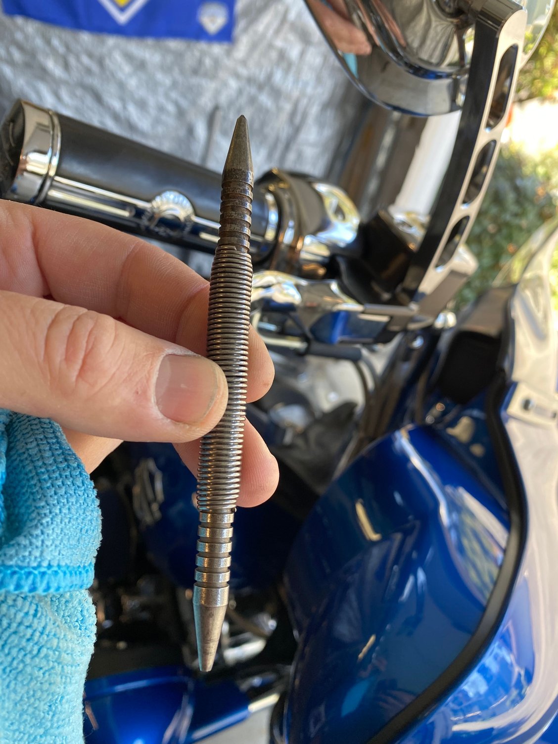

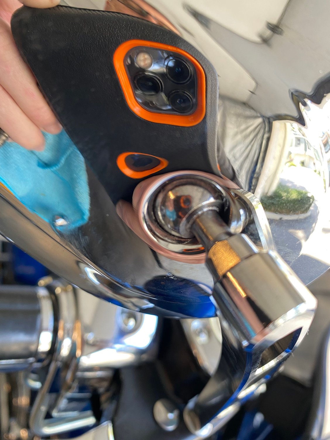

Default Loose mirror head fix
New mirrors were a bit loose and they wouldn’t hold position after being adjusted. It drove me nuts within the first 60 miles.
I was considering replacements, but decided to try a fix instead.
Most of the ball end is inside the mirror head when adjusted, so I used a spring-loaded center punch to make a couple of dimples on the ball, as far inside the mirror as I could.
This seems to have increased the friction between the ball and mirror head enough to eliminate the floating mirrors.
If it works, this will be the cheapest part of my rebuild.
