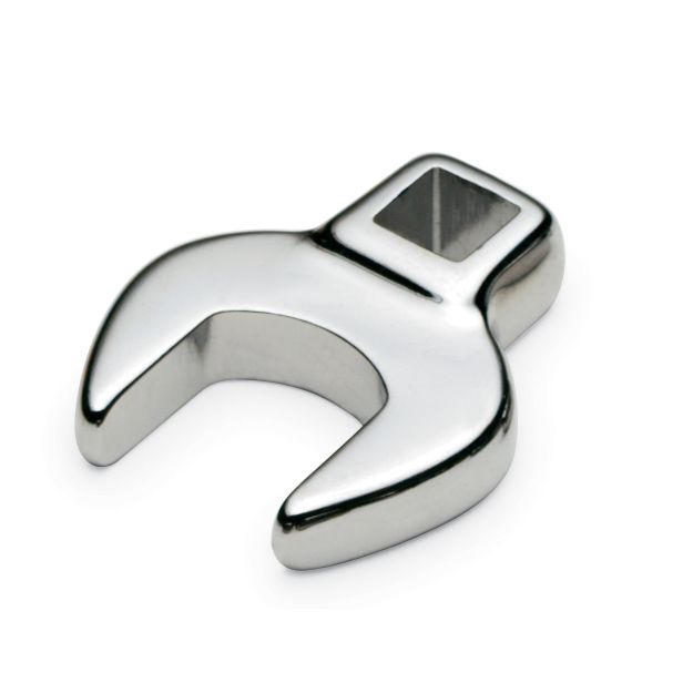

How are ya holding the adjusting bolt while ya tighten the nut???
Old May 20, 2008 | 02:53 PM
RoadKing_Al's Avatar
RoadKing_Al
Joined: Oct 2007
Posts: 602
From: Lakewood, N.J.
Default RE: clutch pack adjustment?
Put a extension on your torque wrench and use an open end crowfoot.
