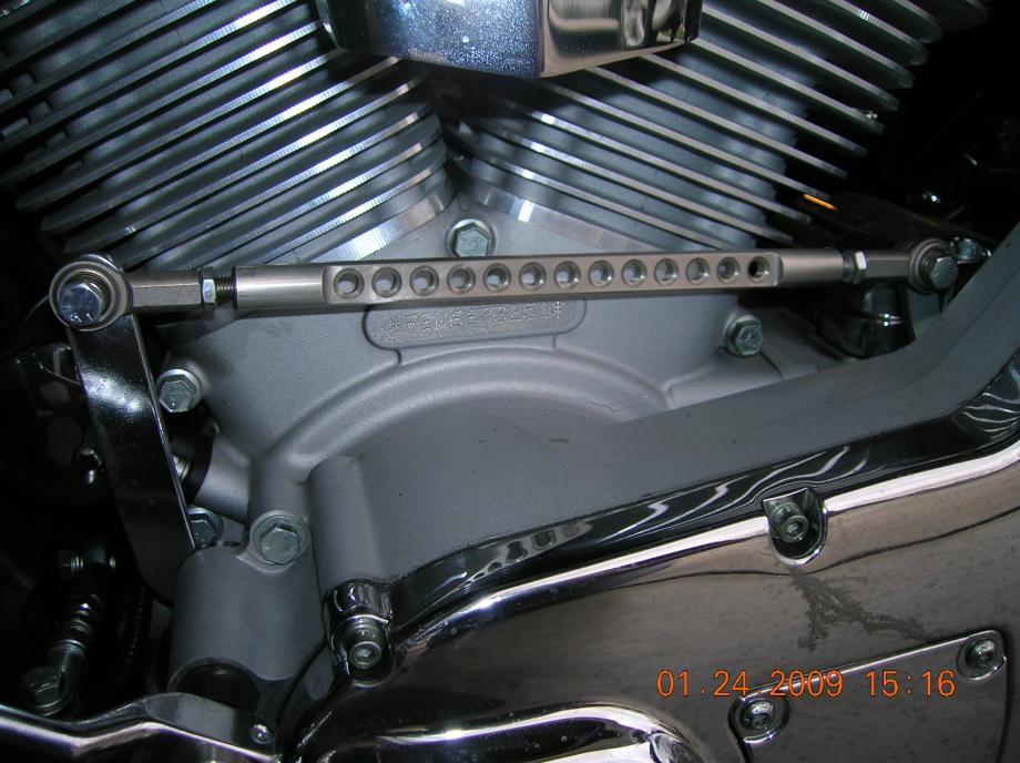

i made my own linkage as well and have mademany for friends etc ,am now looking for chrome or stainless rod ends to replace the stock ones, any ideas of the best place to find them at a reasonable cost? thanks

I made my own shift rod out of 303 stainless and bought 303 stainless rod ends from McMaster-Carr.
