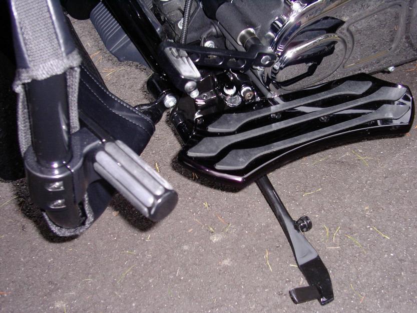

I just recently took mine off to paint it. Per the manual, you are supposed to loosen the bolt that holds the arm onto the bracket. Once you do that, you can move the arm forward, past the down position, and the spring will either come off or can be put on easily.
