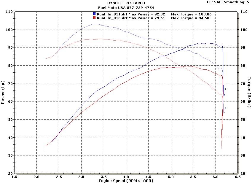

I disagree, take a look at this chart comparing STOCK cams to WoodsTW6-6 cams in a stock 96" with the Fuel Moto package and you will see that even the stock cams are very decent compared to a lot of guys charts with "upgraded" cams....... just saying.
http://www.fuelmotousa.com/09jackpotvstw6.jpg
Goes to show that there is much more than just cams to consider when looking at a bikes performance.
