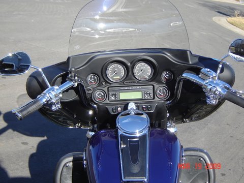

Had the shoulder "burn" when I got back from a trip out west in 2008. Over 4,000 miles. Swapped out my bars for Wild1's. WO575. Solved the problem. 2inches up, 2inches back, from stock.

Thanks Dan,did you have to get new cables to fit new bars?
Mine just fit! Routed inside. Worked out great.
