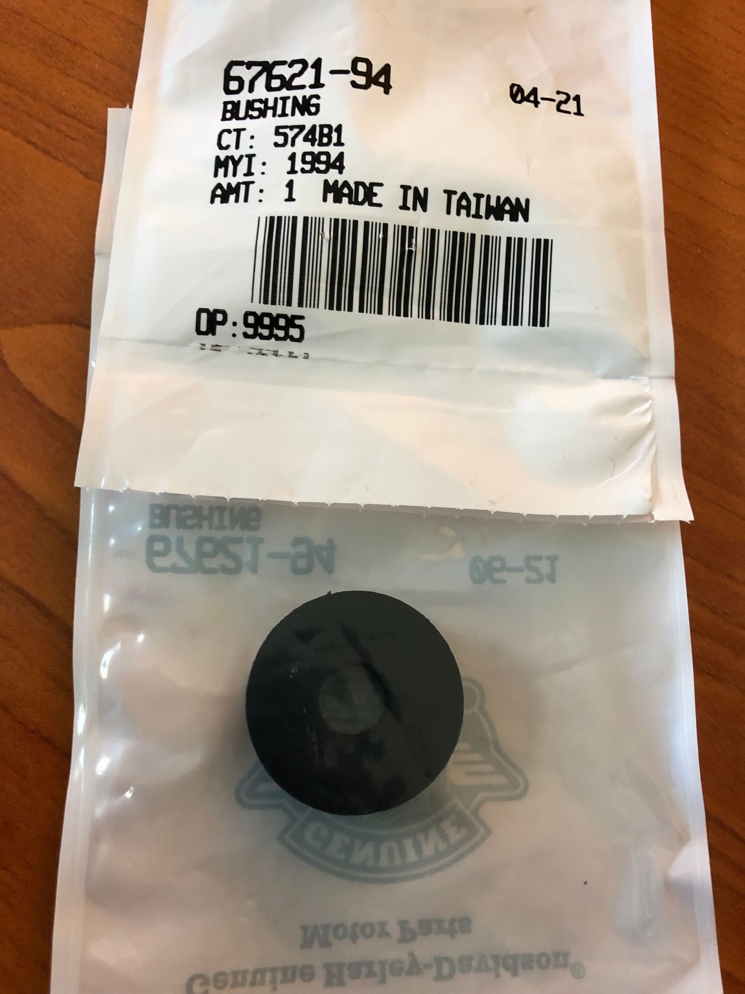

Hi you all, does someone know if those grommets are round or oval ? I bought a set of those and they don't fit in the mounting bracket, should I try to rotate them to find a way in or another idea ?
Thanks for your ideas !
Old Apr 24, 2022 | 05:44 AM
foxtrapper's Avatar
foxtrapper
Veteran: National Guard
Joined: Nov 2012
Posts: 6,191
Likes: 2,423
Round, as I recall. They are hardest to mount a windshield on when they are new. In use, they get squished, and subsequent removals and installations becomes easier.
You might try lubricating the rubber, to let the mount more easily slide over it.

They are round. I keep spares as I've already changed them on my '13 King. I regularly change from windshield to a detached batwing. The trick is they have a center groove and you have to align the bracket to the grooves. Might flex the windshield a bit so the brackets align.
