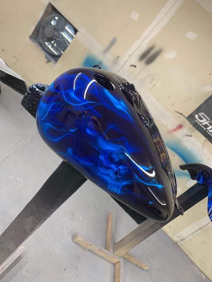

Default Wire harness
If that number 8 wire harness is available it would work awesome. But if not,I will be building a harness up to work. The tank fits great on the bike.
Thats the only issue, figuring out the fuel gauge.
I will have the original tin for sale once this is up and going
The newer tank
