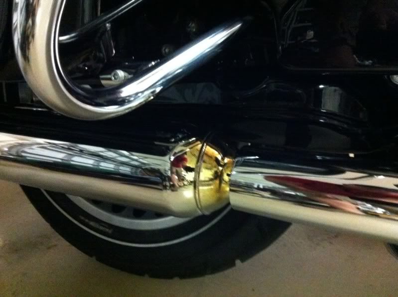

Stock exhaust setup on 2010 RK. is this bronzing normal? If so, what would cause this to happen on one side and not the other? Something to do with the head pipe in 2010 Models?

Heat from the cat and lean tune, my 2010 flhtk did the same thing

Catalytic converter in the head pipe is likely getting hot enough to cause the yellowing.

I even had a blue hue in back of the cat, now thats hot get rid of that cat as soon as you can.
