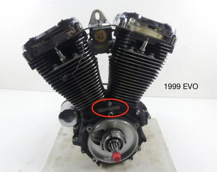

If it's a Harley EVO engine;
The later EVO engine identification numbers will be on the primary side case, just above the primary, and centered between the cylinders.... Internet pic
The earlier EVO engine identification numbers will be on the primary side case, just above the primary, and centered below the rear cylinder... Internet pic
Post pics if you can...
Let us know if it has a Harley engine identification number. Then we can tell you what it is...

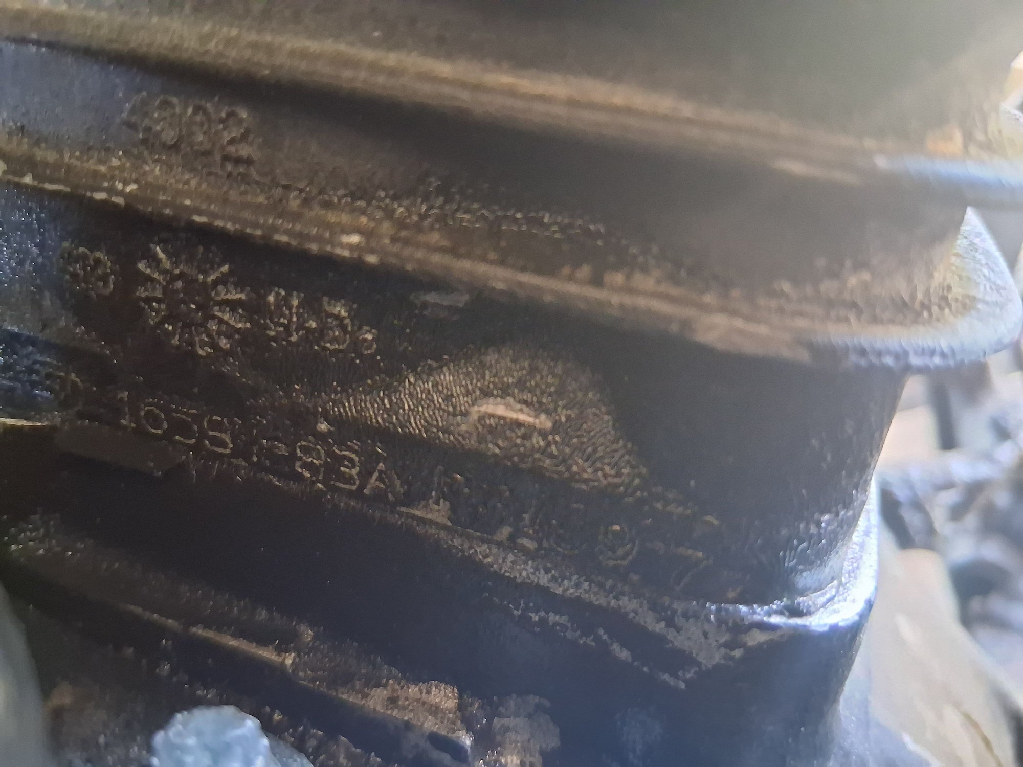

I found some numbers on the right side behind the lifter block
Here are some more numbers I found
