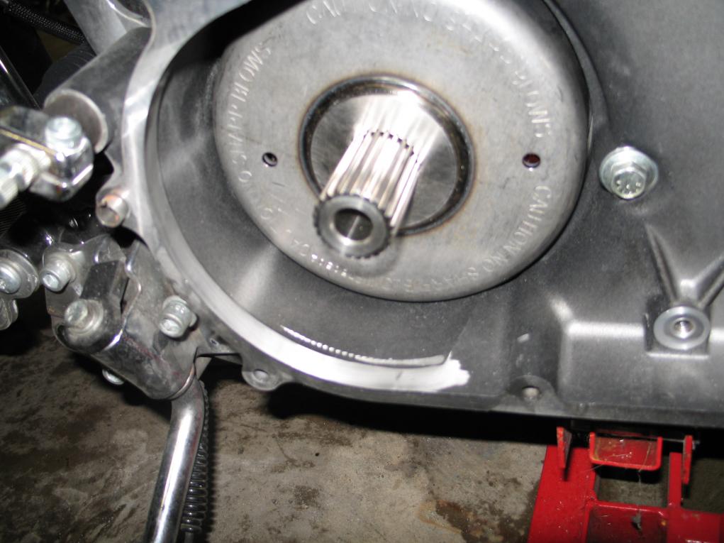

there is a alot easier way than taking the entire clutch apart and the inner primary as harley says. the raised lip along the inner edge gets ground down. heres old post on it. his grinding jobs was left pretty rough. I used a flapper wheel to smooth my case right out. you dont need to grind any of the gasket face off, just grind the bump down may angle up abit magneto will come off.
https://www.hdforums.com/forum/dyna-...mpensator.html
I just used a piece of flatbar I got from work
Attached Thumbnails Screaming eagle clutch-prime-4.jpg   Screaming eagle clutch-prime-3.jpg   Screaming eagle clutch-prime-9.jpg
