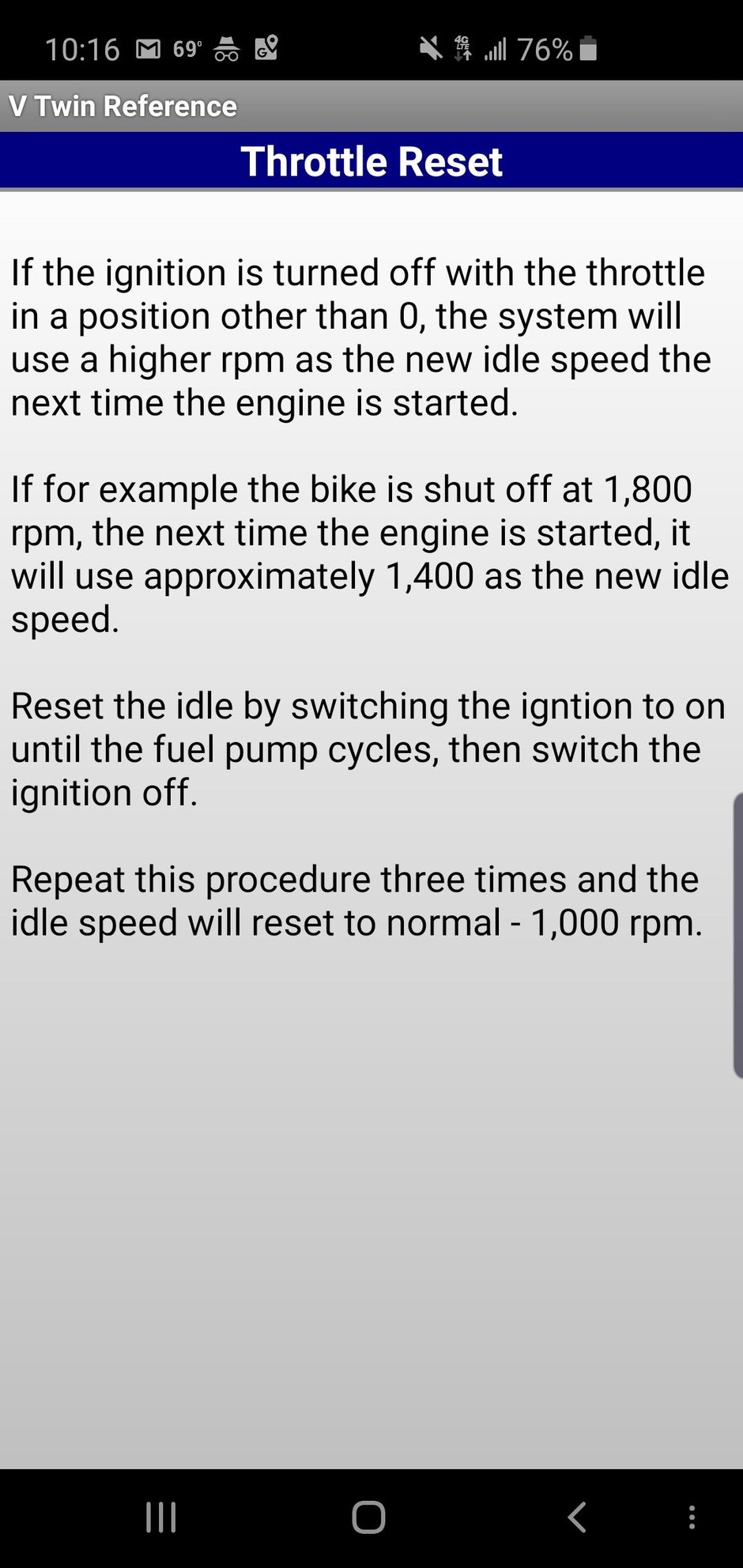

Default High idle
Originally Posted by Ultra Street Jewell
My 08 Street when it first starts up has a high idle till it warms up. A lot of that may have to do with the power commander you have.
Tried it and it fixed it! Thanks!

Try the throttle reset procedure. My 08 has done this a few times and it has always worked for me. I do believe the run/kill switch needs to be in run when you cycle the ignition.
