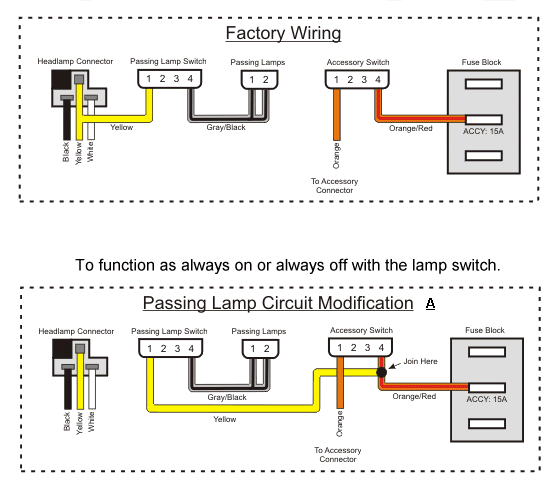

Originally Posted by BuzzCap7
With the HD Cruisers, when u put the high beam on, the spots automatically shut off.
Thank you......
BuzzCap7
Not if you MOD the wiring.
I run spots all the time and a headlight modulator during the day. If the flashing headlight annoys anyone, at least they see me.
Thank you......
BuzzCap7
That can be fixed.
