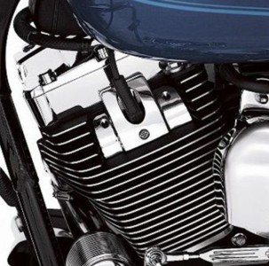

I've asked this question before but never got a response from anyone who installed the fans on their bikes and who also have the HD Cylinder Head Bridge Covers on them. If so, do the fans still do their intended job?

i just installed my fans today and i have these head bolt covers and the fans work great!
