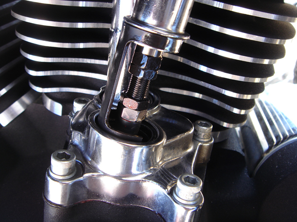

Our Fuel Moto pushrods work with the stock pushrod tubes no problem and we include a special tool for holding them.
Here is a picture with the pushrod tube holder in place that shows the access to the adjuster:
