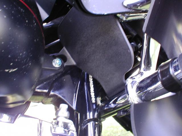

I'll try to upload a picture.See attached thumbnail. I't should help you.

Here is a pic of what they are talking about. These came stock on my Ultra.

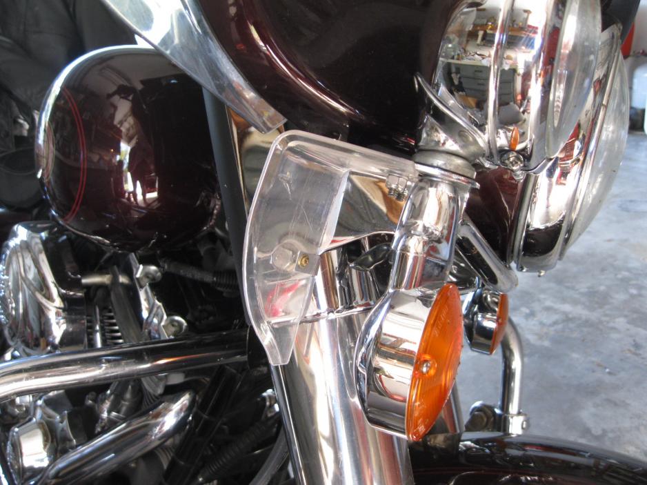

The Photo makes them look big, but they are not.
I cut up a lexan file folder, kind you hang on the wall for folders...
It's about 3" wide and 4" long and clear. Straight on it is about to the edge of the spot light
It could be a little wider but the wind decreased ALOT.
Very littel wind compared without.
I do not like the look of the chrome swords so I thought long and hard and came up with these
Attached Thumbnails How to decrease buffeting from gas tank-light-deflector.jpg

Nice job, katobird. How did you cut the lexan fileholder? How'd you get the edges so smooth and the curve so uniform?
thanks,
