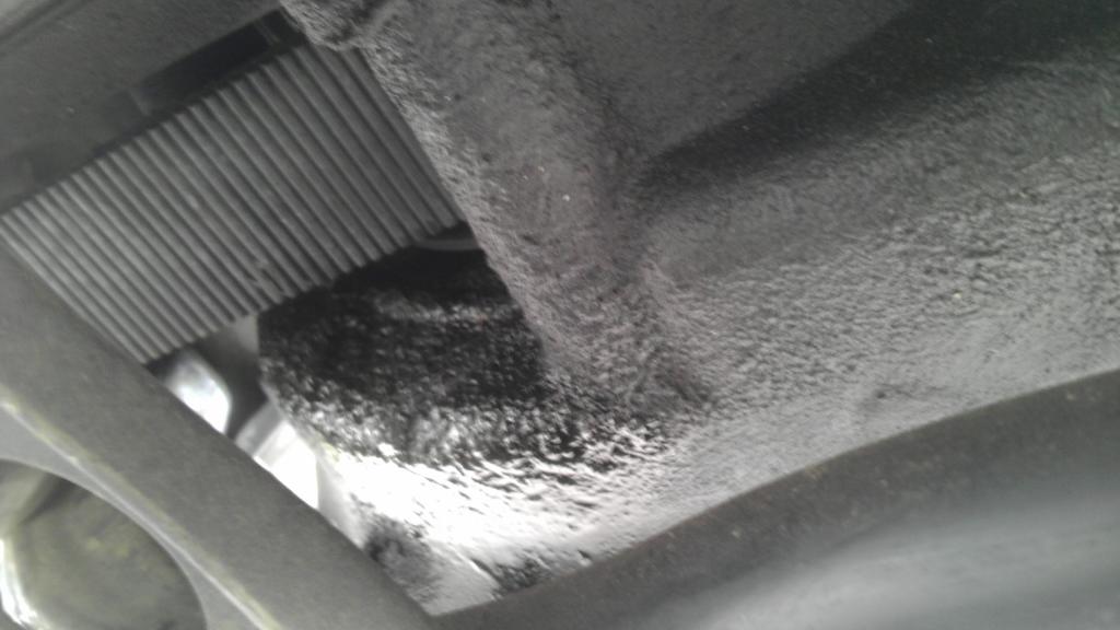

Hi I just got a 2000 harley road king. I notice that after i am done going on a ride i get about 5 drops of a brown fluid leaking on the left side by the shifter. it does not leak if the bike has not been running only after the bike has been run. It looks like it is coming the sprocket where the belt is. but i am not sure, any help with be great!

I am guessing the second pic is of the inner primary? If so then it appears to be an inner primary bearing seal. Seems to be a rather common leaker. It would also require the bearing race, which is installed on the transmission mainshaft, to be replaced also.

Maybe the tranny input shaft seal where it goes through the output shaft at the pulley?
I know this is a very common leak-point on the old 4 speed trannys.
Also might be the inner primary bearing/seal.

If it's an inner primary seal that's leaking, that could be an indication that the bearing may be failing too, but not necessarily. If it's the tranny input shaft seal where it goes through the output shaft, then it's no biggie as long as you check your tranny lube level and the leak doesn't get any worse.

By the looks of the first picture it looks like your derby cover is leaking. I would check that by replacing the gasket and wipe the oil off the lower back side and give that a try before anything else!

I'm thinking shifter shaft seal. Mine was similar til i had the seal replaced. No more drops in the floor.
