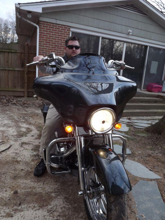

cweiss's Avatar
cweiss
Posts: 1,022
Likes: 70
From: Greensboro NC
I am 6'2" and I ride a 07 Streetglide. I recently had a set of 16" cyclesmiths apes that I had HCC (hillcountrycustoms) package up for me. I would say go 14" at least since you are 6'. Good luck!

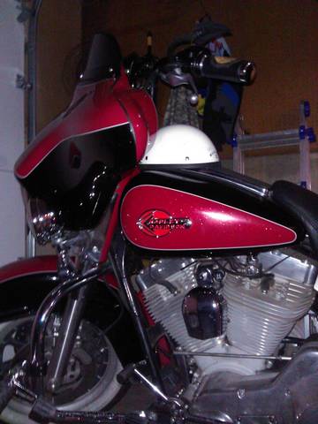

chinookman's Avatar
chinookman
Joined: Nov 2011
Posts: 152
From: Pendleton Oregon
I am 6 foot. I put the Yaffee classic apes 10 inch. They are right at the top of the fairing. The are the 10's but they measure 12. Really like them.
