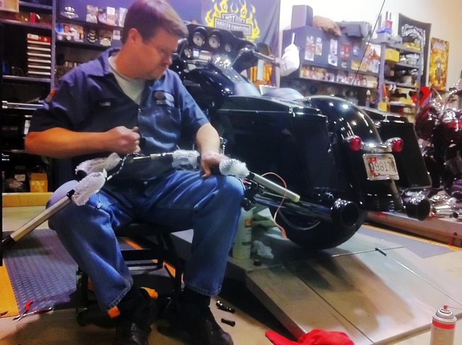

I just came from my dealer who is installing 10" Yaffe MBB on my 2012 SG. He was NOT enjoying it. Cussing himself and the wires. Can't imagine I'd still be breathing if I tackled this. Yaffe wasn't thinking about how hard of a process it is to wire them.
