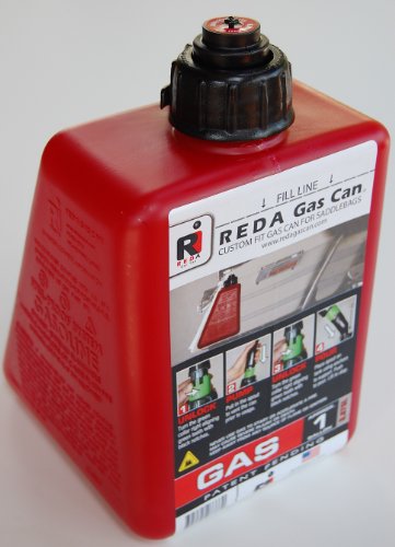

Originally Posted by 103megawatt
So what about all the millions of dirt bikes riding out in the desert all year round or everywhere else in the Summer months? Dirt bike tanks are made of plastic. There are billions of plastic gas containers around the world made by many manufacturers. If a "pretty warm" storage compartment would cause a plastic gas can to actually split/burst (OH my!!!) then there would be millions of fires every day from plastic gas cans stored inside a hot garages, hot travel trailers, a even a couple thousand Harleys that use the 1 gallon gas can stored in their saddle bags.
To the OP, contact the manufacture see if they will give you another one. Or just go purchase another can and maybe try different manufacture.
Plastic gas tanks on dirt bikes, ATV's, lawn tractors, chain saws - you name it -and the like are vented. 1-gallon plastic containers in your saddlebag are not. There's a reason this one started to split, and it's not because it simply got weak sitting there empty. Internal pressure caused it to expand and the seam began to fail. That's not good. Your profile name implies maybe you work in a power plant. If so maybe you can understand the principle of liquids expanding when heated up and the bad things that can happen if the vessel can't handle the added internal pressure.
As to the couple thousand riders with these in their saddlebags (your number, which is arguable), I'll bet the OP isn't the only one this has happened to. The rest have been lucky IMO. Drop by your local fire house and ask them if they think it's a good idea. If you want to put that liquid dynamite in your saddlebag, be my guest. Just be aware of the possible outcomes.

Originally Posted by pastime
.... If so maybe you can understand the principle of liquids expanding when heated up and the bad things that can happen if the vessel can't handle the added internal pressure......
Anyone filling up any container (plastic, aluminum, steel, etc) to the top and then sealing it up, transport it in a vibrating vehicle in the heat is certainly asking for trouble. Simple solution is leave some air space for expansion. Its not rocket science to cure the problem. And the REDA gas can as well as others have a "FILL LINE" printed right on the can to handle the internal pressure. Its not the cans fault if somone ignores this.
.....If you want to put that liquid dynamite in your saddlebag, be my guest. Just be aware of the possible outcomes.
That is exactly what the REDA gas can is designed for. Carrying a small amount of fuel beats walking asphalt out in the desert and especially when your out of cell range. Hell yes I will carry fuel, the Highways in the West has many miles from station to station. Just don't fill the can to the top, don't be a worry wort, and enjoy the ride.
And yes all the vessels and tanks in the powerplant have room for expansion by means of a mechanical or logical (computer lockout) methods for prevention of overfilling it to prevent what your were talking about.

Been carrying a Reda can in my left saddlebag for years. It hasn't split. My stuff doesn't smell like gasoline. I and I haven't blown up yet. I have a 117 and get just a little over 30MPG (its fun though). I need the extra sometimes.
The 5 gal welded vented tank sitting between the "boys" sits right above a very hot engine. That doesn't bother me either.
