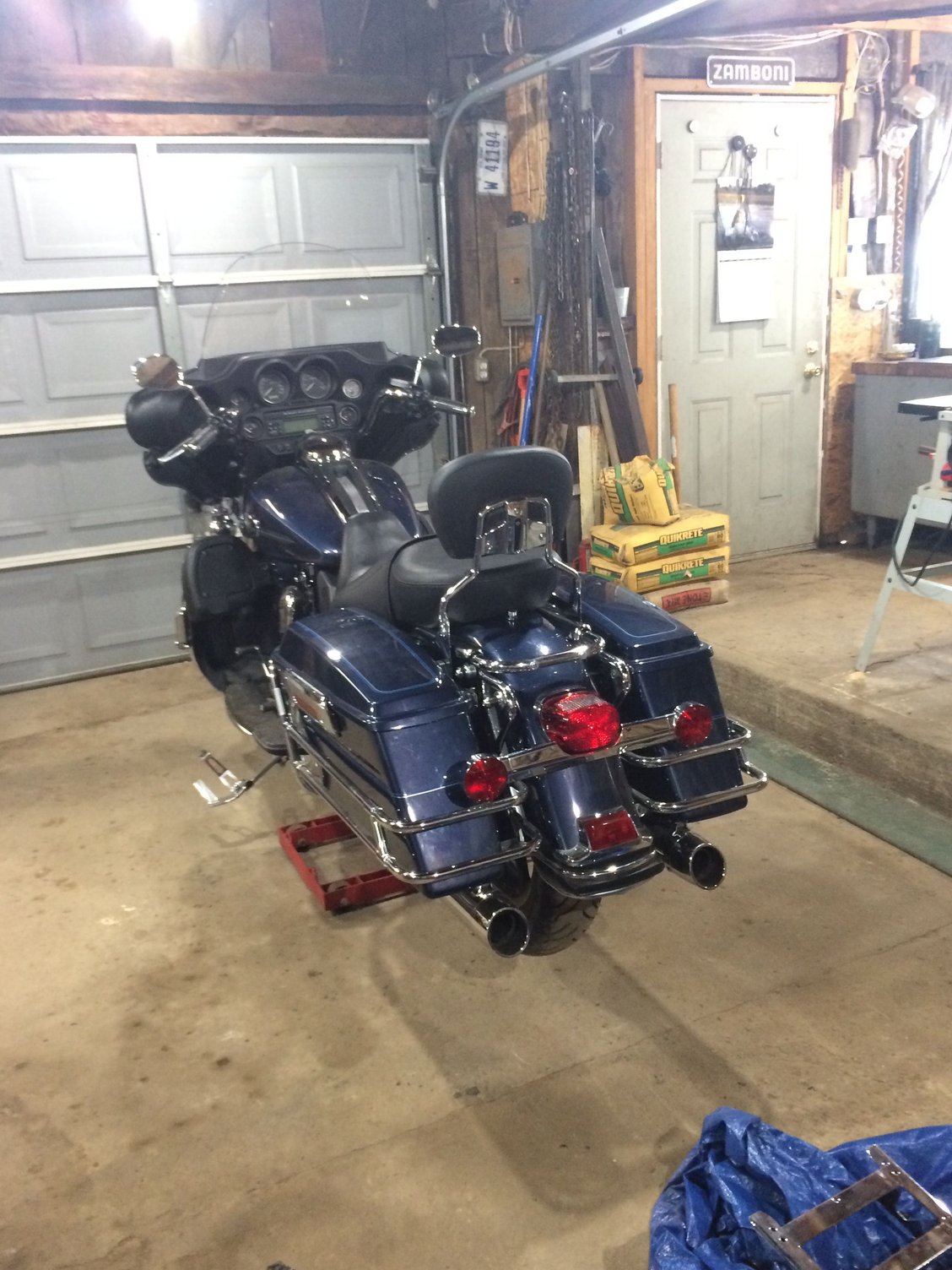

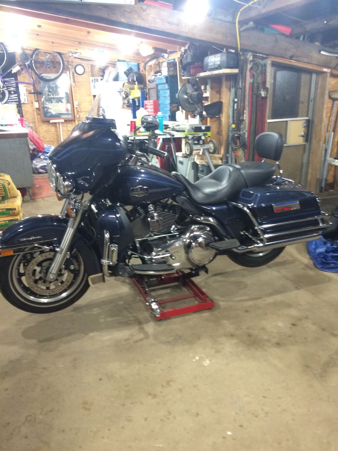

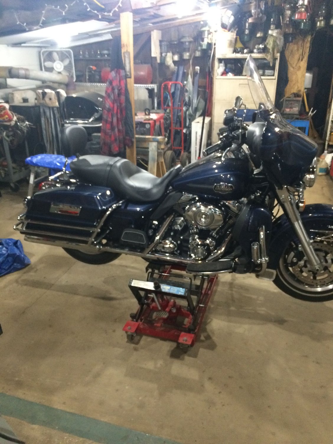

So, yesterday I hit the garage and dove into the detachable conversion.
I bought both rear and front docking location sets and also bought 2 different tour pack mounts.
Started out with the bike on the jack for levelness.
Removed bags and seat.
Removed tourpack and mounts.
Installed front mount near the shocks(simple). Not impressed with the rubber and plan to make my own replacement bushing or buy a set from somewhere.
I had recently picked up a rear backrest off craigslist.(genuine HD)
I placed the backrest on the front mounts to confirm where the rear mounts to it needed to be.(I have seen lots of pics posted here and also subscibed to several threads that I used for references.Then I spaced it out properly (rear mounts).
Next, one of the tour pack mounts I bought mounted on these front mounts. I placed in position and imediatly saw that it would set the pack at an angle downward at the rear. Also the mount sides were parallel and did not fit at all. I could have bent it or changed the mounts but then I could not use eith the passenger backrest or tourpack without tools and time. Sending that one back. I sort of hoped to avoid the rear loop mount thing on my 2008, Oh well.
So I was left with the rear docking kit to install and use the "standard" rear docking mount for the tourpack.
This went on easy and after a bit of sorting through hardware I was all mounted up.
I placed the rear saddle bag mounts behind the black plate so as to not angle the bags outward at the top.
There is a little wiggle at the top of the passenger seat. I may try replacing the plastic bushed mounts with solid aluminum mounts eventually.
Anyway, I have a bit of wiring to decide what to do with but for now I will detach it and simply tuck either side into the saddlebags and close them. It seems to work.
Quite pleased with the end result and option to remove the pack.
fwiw, I bought all the parts on ebay and they are all knockoff(china) parts. After seeing the Harley prices and the box they come in with "made in Taiwan", I had no preference if my parts came from the island of Taiwan or mainland China.
Thanks to all who have posted the endless threads on this conversion. I read a bunch of them, and used them as references. they helped me a lot.
The whole deal took a couple Hours
