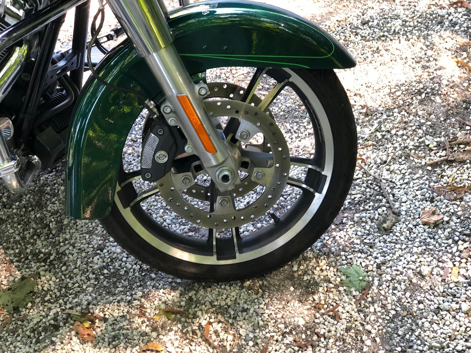

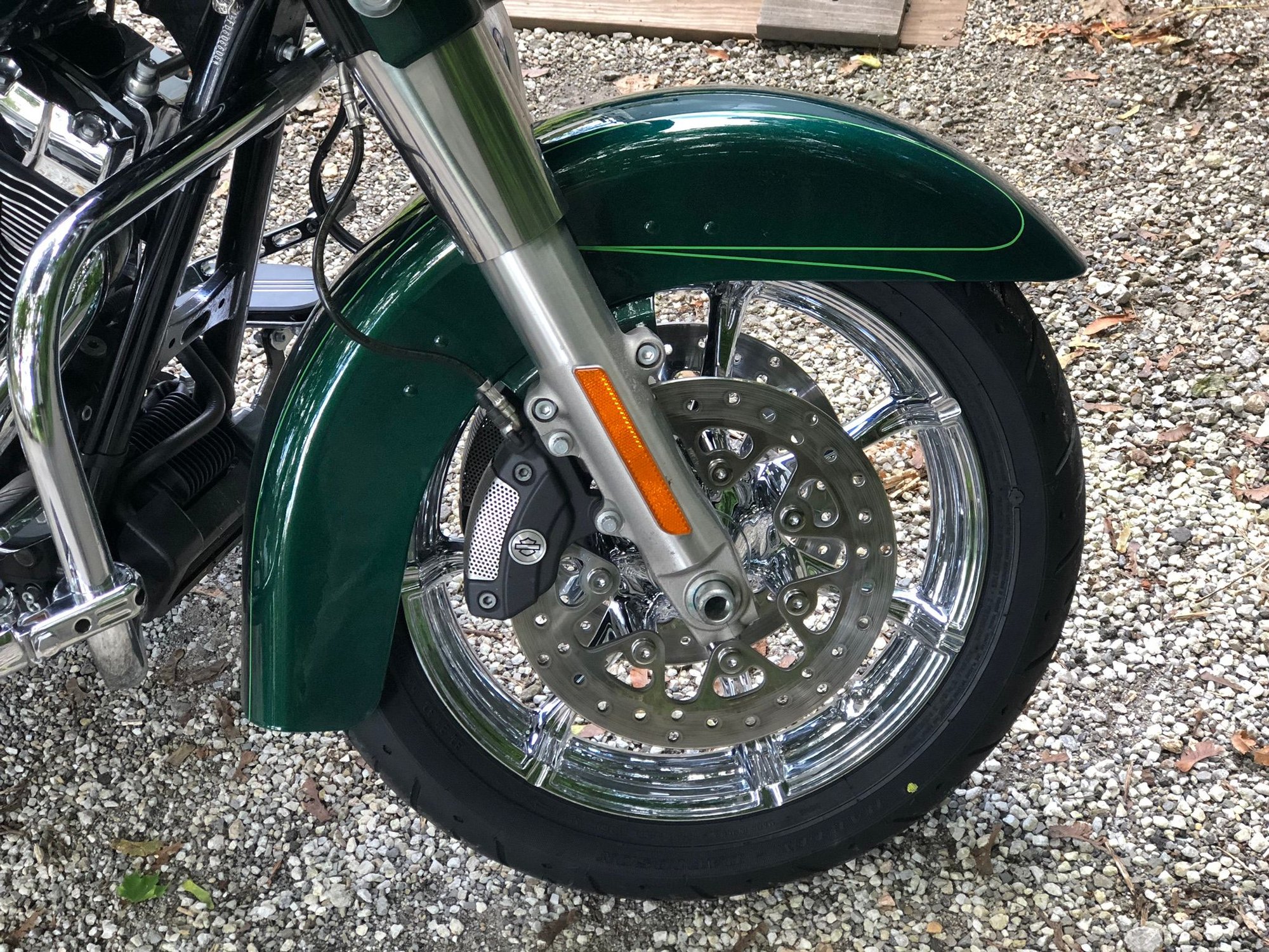

So far so good, ride is improving, but still not happy with the Handling, after some research I decided to change the front wheel and tire., unlike a lot of people, I decide to go from a 19" wheel to a 17" wheel and the appropriate Tire Change.
2015 Street Glide Front Comparison Stock vs Modified
2015 SGS front(stock) 2015 SGS Front(slicer)
19” inch Wheel 17” Inch Wheel
130/60 -19 130/80 -17 Difference
Diameter inches (mm) 25.14 (638.6) 25.19 (639.8) 0.05 (1.2) 0.2%
Width inches (mm) 5.12 (130) 5.12 (130) 0 (0) 0%
Circum. inches (mm) 78.99 (2006.22) 79.13 (2009.99) 0.15 (3.77) 0.2%
Sidewall Height inches (mm) 3.07 (78) 4.09 (104) 1.02 (26) 33.3%
Revolutions per mile (km) 802.18 (498.45) 800.67 (497.51) -1.5 (-0.93) -0.2%
BEFORE
stock 19 inch wheel
AFTER
17" Slicer Front Wheel
The Change in Handling and road imperfections coming through the handlebars was absolutely amazing, this is the ride I wanted and ex[expected. Too bad it took so many changes to make this ride what it should be..
