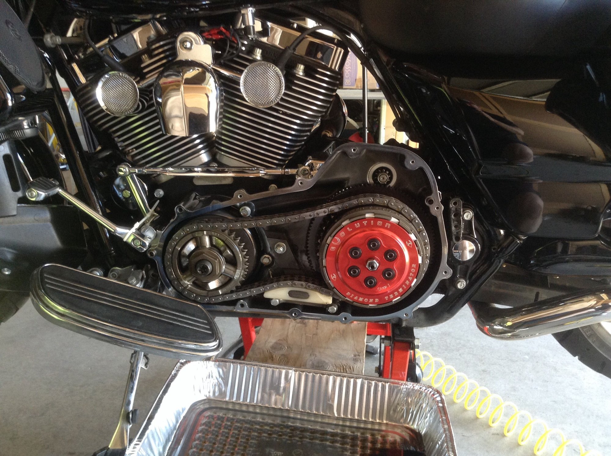

I have Hayden units on my 02FXD and 05 FXDLI, they've been installed for a long time and no problems. I installed the Hayden on my 2013 RGU at 1,500 miles, just removed it today (5,560 miles) and reinstalled the stock unit. The howling noise was just horrendous, the shoe was worn down to the rollers on the chain and the shoe was pitted. Rode to the dealer bike night tonight and boy what a difference, nice and quiet.

The issue with the Hayden that it is too short and the loop over the tensioner has a bit of angle on it.. Anyone that like to use the motor for compression braking will chew on of these up on a new model bike (6 speed)... The later bikes have use a 34 / 46 sprockets compared to the 25/36 or 24/37 of the early TC.. The early TC had room to place the tensioner under the chain inside the primary without to much angle on the chain..
