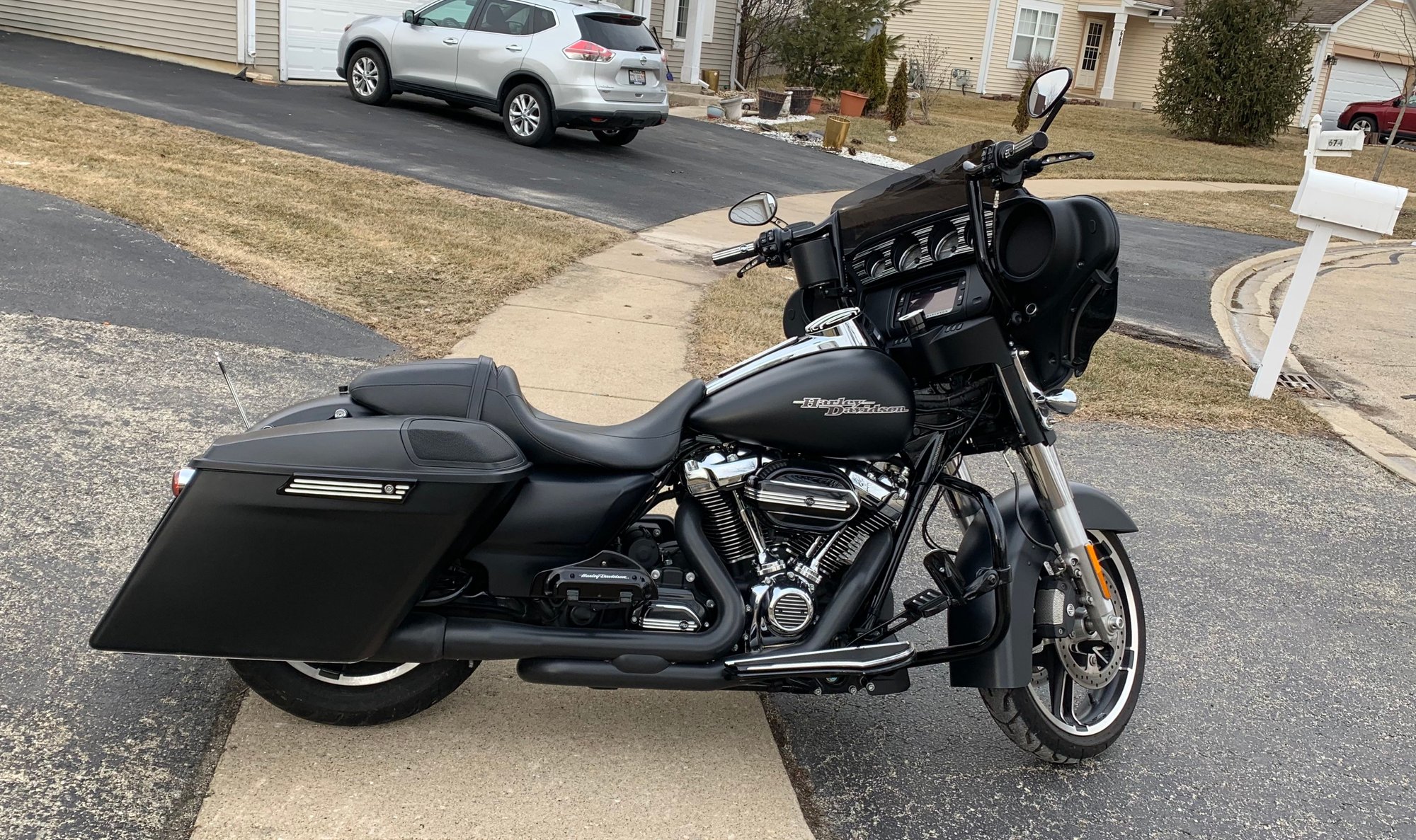

I have a front only on order for 17’ Street Glide Special. As soon as it’s on and I get a couple rides in I will post the results. I find that on longer highway curves (approximately 1/2 mile 90 degree) around 90-100 I start to get the wobble. At that point I usually have to let off for a second, then make sure there is constant acceleration to minimize the wobble.
For or those who didn’t see at the top of the website there is an installation link for the different models. Looks pretty easy but I still defer to my master tech. The bags each have 10” woofers with 6 x 9’s and chopped pack always has minimal weight.
